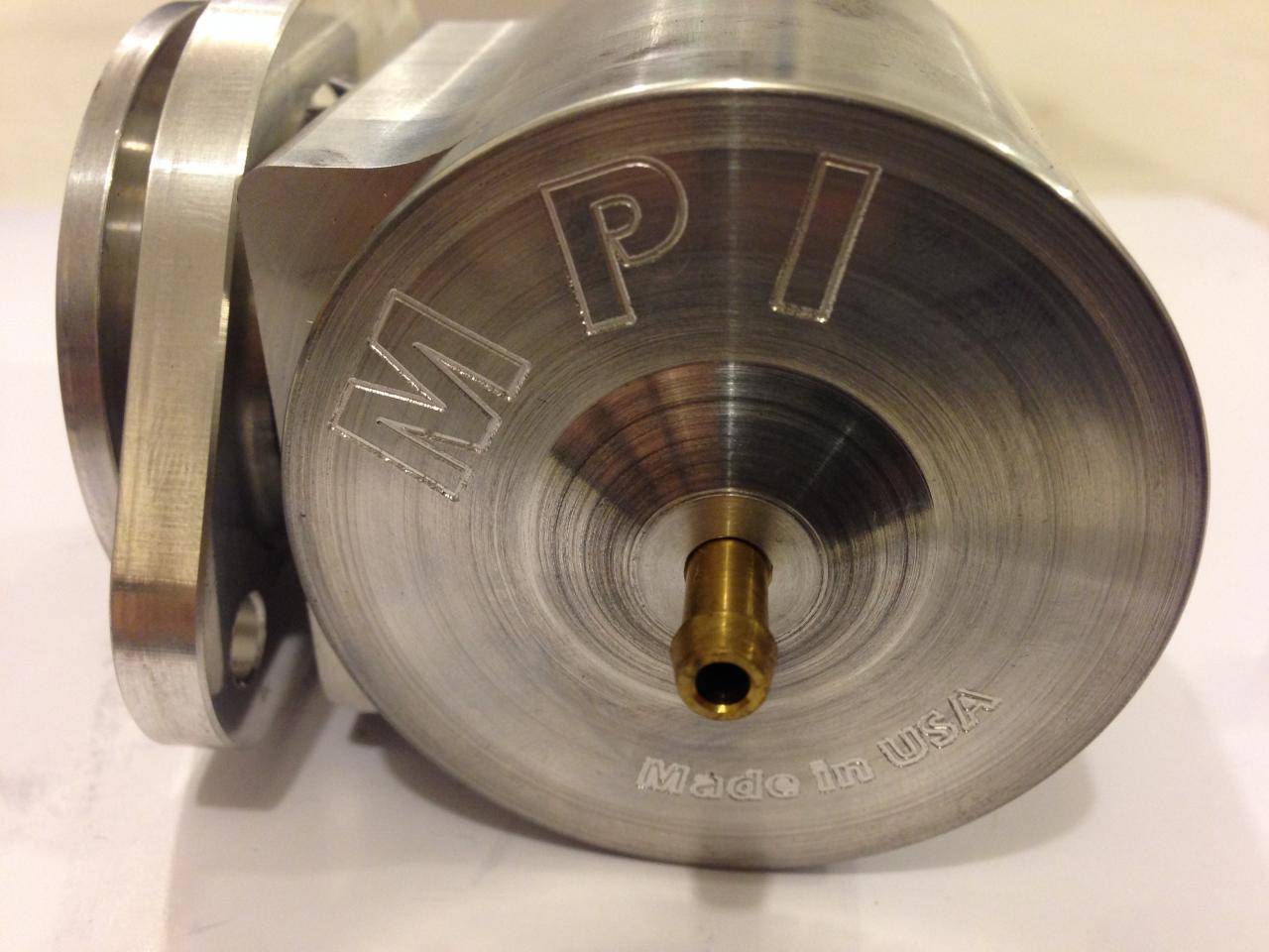

Our valve utilizes a billet piston with o-rings, rather than a diaphragm. It also one sensing port, rather than 2.

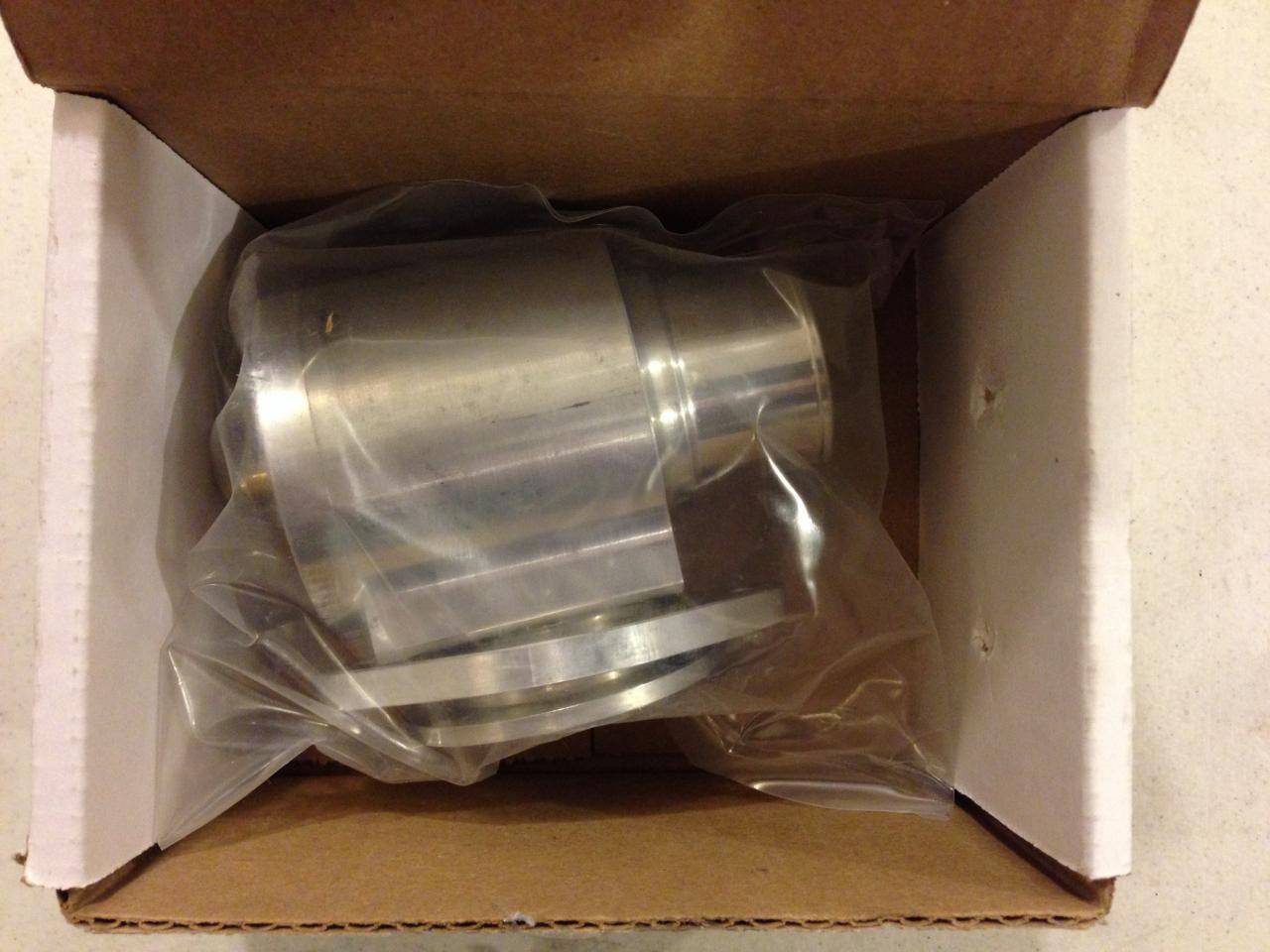

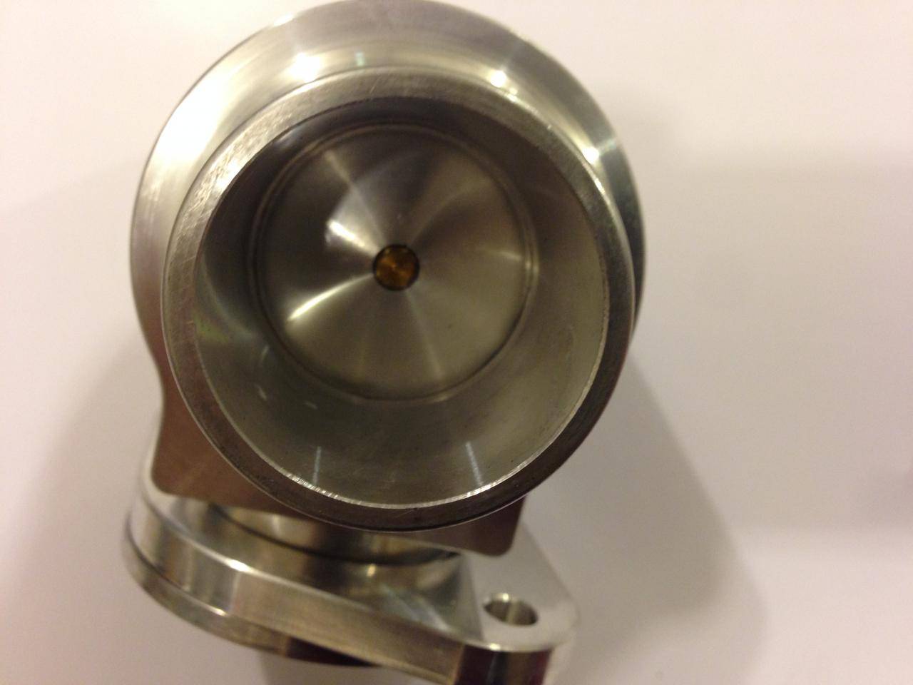

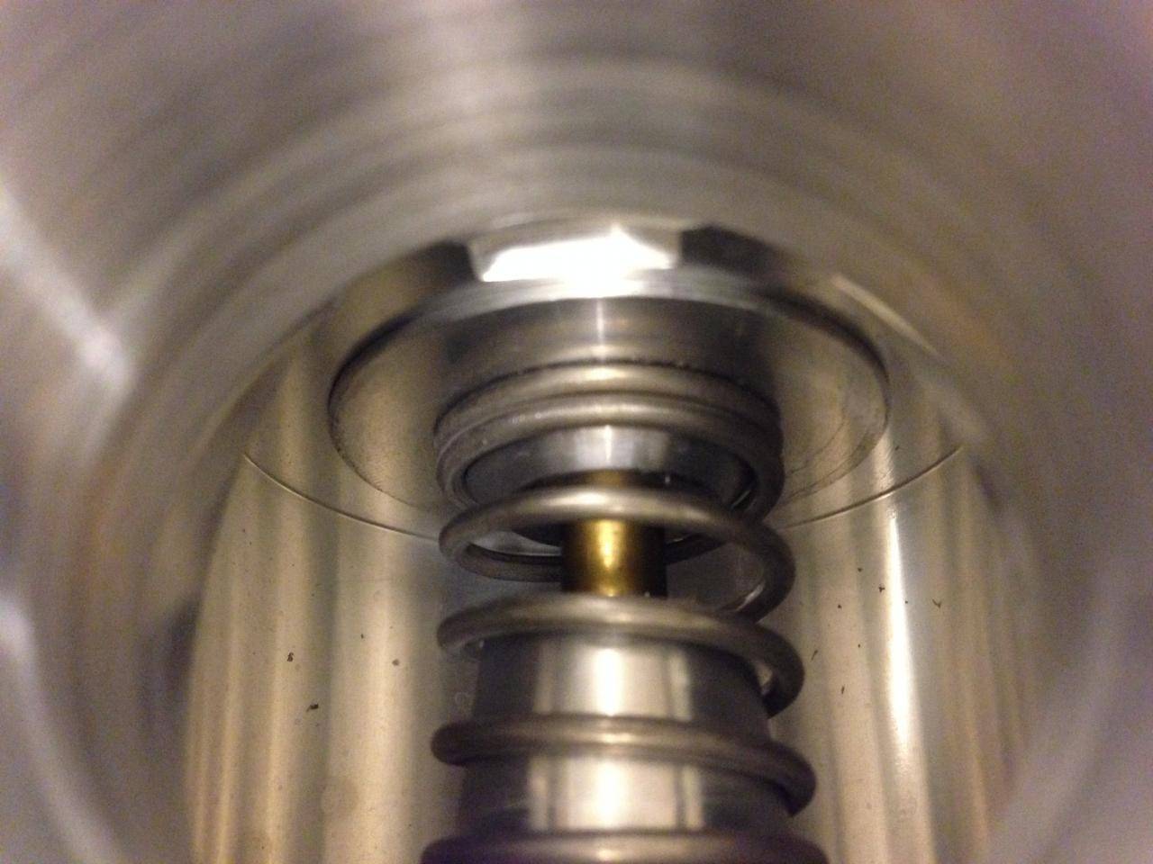

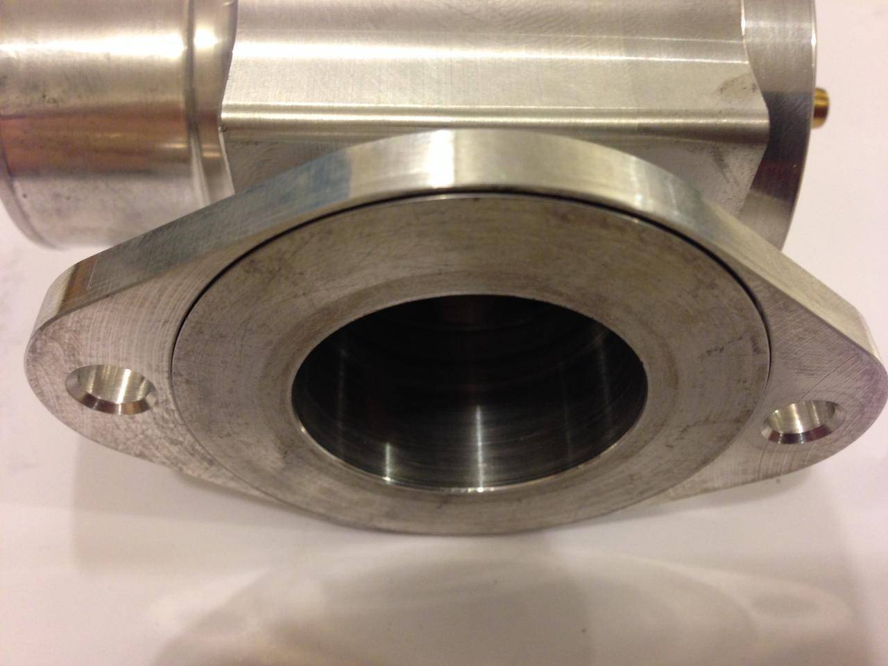

Matt from MPI was kind enough to send me their 2nd generation BOV.
Finally got it installed this evening.!
