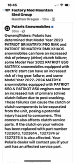

Looks like theres a clutch recall

Mines just an 850 no e start and I got the email too. Guess the p-85 is having issues now? I’m hoping they just replace the clutch!
