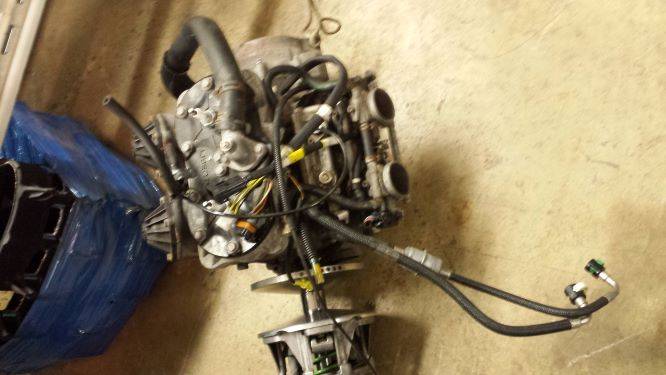

This was what I came home with from a swap meet. I purchased it as spare parts for my sons 1991 Indy Starlite. 250cc air cooled this engine was installed in sleds without an expansion chamber, a 30mm carb, and only a muffler, so that limited the power output. This basic engine also shares parts with the Polaris ATV. I found some info where someone replaced the cylinder with an indy trail fan cooled cylinder. Did some more research and found that the bore and stroke were the same, and the indy trail had much larger ports and ran a larger carb. Some modifications to the cooling fins would be needed to wrap the starlites tin around it but that would have been a good upgrade. If a tuned pipe were made the upgrade would be even better.
Went to Hay Days last fall and found a used Fuji Indy 500 cylinder and head. Was able to get it for 10 bucks, and when I got it home I found that the bore and stroke were also the same and the bolt pattern on the base were the same except that one hole would need to be drilled as the Fuji uses one common stud between the two cylinders on the carb side. I took the band saw and cut it in half. It bolted up and the piston and ports all were where they should be. The 500 has the water pump bolted on to the cylinder so I used the mag side and thought it should not be too hard to get that water pump to spin so I prepped the cylinder for welding up the water jacket. The 500 puts out around 80 hp so I am hoping to get around 40 with an expansion chamber and a larger carb. The 250 four wheelers when modified were also in this power range. As this is HP in the same range as a 340 my plan was to gear this sled down for a top speed of around 50 Mph so it will be able to spin a 141 cobra 1.6" lug track.
