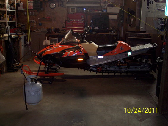

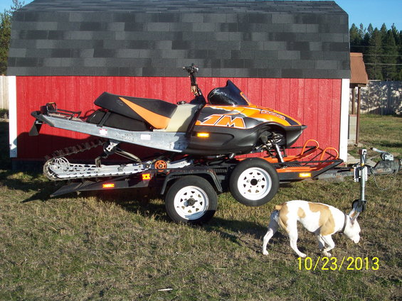

I'm a little confused by your post. My '04 KC should have the exact same stock seat as your '02 MC. My seat wasn't "connected" to the tank though. Just a little lip that would slip under the tank and 2 clips on at the rear.
The WRP seat is listed to fit '02-'06, so you should be able to run the same setup as me.
Just for reference, here's a pic of my '04 KC9 when I first brought it home.
Same sled as pictured above with the WRP seat.
