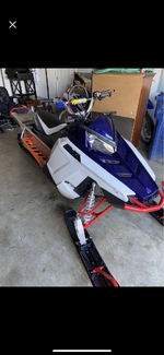

Might bite the bullet and get the turbo as they would take $3000 and do the fix it kit with the saved money. Will be pulling the clutch and compression before purchase to confirm the better crank and that it’s in ok shape top end wise. If I do check it out. Added photos of the turbo sled.

I'd try to find at least a 2013 just for the better crank. My 2012 got a fresh top end "fix kit" as preventative maintenance at 2300 miles, and then at 2800 miles, it lost a lower rod bearing and took out almost every piece of the engine. I priced it out to rebuild it and it was about $2800 in parts if I remember right. Tried to find a whole used engine for cheaper but I ended up selling it as a roller.
@05rmksteve hit it pretty well. The '12s aren't necessarily bad, but '13 and up is worth spending more on. Especially if the bonded A-arms have been replaced (one thing that's actually better in the 11-12). Belt drive is kind of a plus and minus in my book: it's geared too high and not as reliable as the chaincase, but there's the weight and rotating mass advantage. I'm not sure I'd mess with the turbo, and the other '12 seems too expensive unless it was a top-to-bottom rebuild; just a top end leaves a lot of stuff that could go boom...

I'd go with #2, newest and less miles. Sled #1 could be a mechanics special (being turbo'd, could be working/tuning on it all winter). Next year buy the sled you really want.
