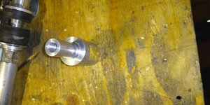

Then made this at a friends shop.
Sized it so that I could use two of the Standard Camso rubber donuts, and a few washers to adjust how long the overall length was by swapping from top of the kit to underneath, similar to how Camso has you set the basic length.
