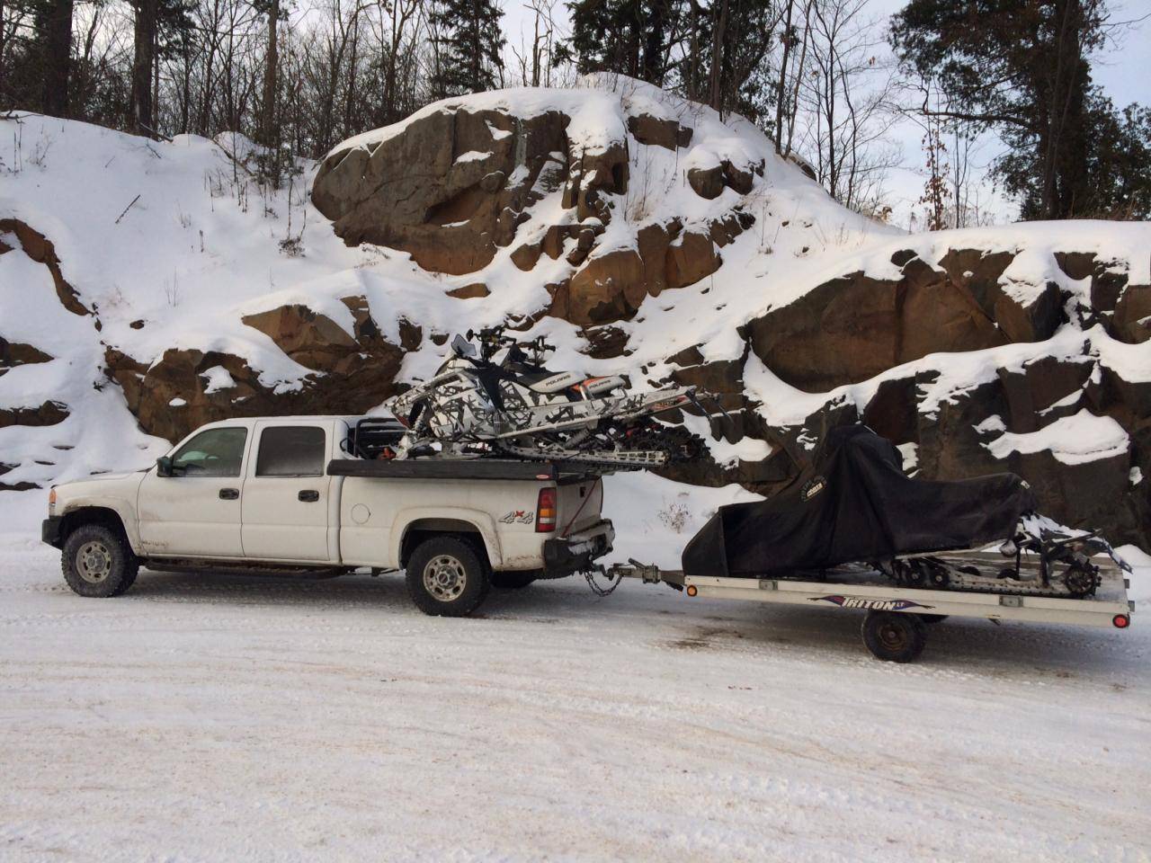

I have a FLM 8' deck on my Dmax 6.5' bed and tow a trailer with it. BUT I installed the Super Hitch receiver with their truss extension. The hitch is designed for cab-over campers to extend the receiver due to the over hang. It is a spendy setup, but it's the proper way to extend your hitch receiver. I have the 4' extension for mine since the sleds stick out about that far from my bumper, but I think I could get away with a shorter extension though. Here's a pic of my set up. I of course have bags on my truck as well.

Die Hard, that is a very cool setup. I like the extension. Does it tow funny? I know my Excursion with the long overhang behind the wheels doesn't like heavy tows, it pushes the truck left and right.
I have an 05 F350 longbox crew with the large deck. Toyup. I could not put my 162 sleds in the middle and tow my enclosed. I actually banged my 146 Freeride bumper on the front of my trailer going up a little hill, with it in the middle.
I have to watch turning, backing up I have to be really really careful. It will actually go quite a ways before hitting the deck to trailer, but it is hard to see.
My opinion is that there is no reason to have sleds on the deck AND in an enclosed in most situations. If my enclosed is not big enough, I will get a bigger one, or just use the deck. The only exception is if you need to drive a long way with many sleds. Otherwise, unhooking to unload the deck is a huge pain. The only reason I had a sled on my deck with my trailer is because I tend to leave my sleds up there, for certain reasons. (See pic, lol.) And if I need to run to the shop to pick something up with a trailer, I just hook up and go, but have to be careful.
