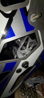

With proper tension (1" at rear shock mount with 10lbs) after my first break in ride - tons of vibrations (perhaps just the extrovert drivers) but I had to check everything over. Other than no locktite on the drive bolts, none of them torqued to spec, and half of the chassis bolts not torqued either, I did find rubber marks on the frame where the tunnel connects. This is a lot of the vibration and a clicking when I manually turn the track.. I think it's due to this contact. Anyone else have this issue? Nothing I can see in the fitment would change this other than the holes being placed wrong in manufacturing or improper design for the 3" track.
anyone seeing this? Is this is across the board on 3" track models? I've got two that came in different shipments so far in January that both have track contact.

that is one 30 mile ride on the photo shown. the other is just a spin around the yard... and although I could see the point of the track having a memory... the track is in contact with the frame and the metal hoops on the upper shock mounting cross shaft. So i can't see anything but the track wearing down a few mm over time stopping this contact from occurring.

I spoke to Dale at Timbersled (Allen's brother) He said the most likely cause was the track lugs riding up on the drivers due to it being dry in the shop, not broken it, and being pushed by hand verse pulled by the drivers. Sure enough, I rolled the track backwards a few feet at his request and the clearance relaxed a bit. Seems like contact will be normal under deceleration, but after break in and normal wet conditions for a few more hours of running it should become less of a problem. We couldn't brainstorm any potential manufacturing flaws or assembly condition that could cause the problem otherwise - so it just appears to need the beatings to continue until morale improves.
