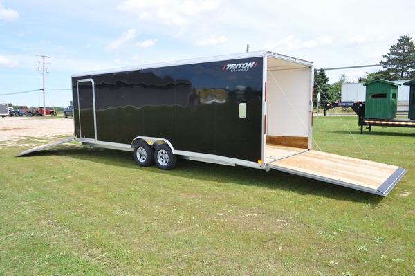

Trailer #1 Triton 8.5ft x 24ft + 5ft V (about $18K)
+ Seems like it is built solid, good door seals, the single door latching mechanism worked slick.
+ Lighter than the other two trailers looked at with the same GVWR = more payload.
+ Chamfer doors, so the flip over flap not needed
+ 5yr warranty
+ Adjustable tie down system
+ Rear rollers incase of ground out
+ Salem Vents seemed nice
-- Didn't like the 2x6 main frame and then 2x2 stringers ran across that for structure holding the floor, walls and ceiling.
-- No spare tire included
-- Not even a basic helmet cabinet included
-- No man door handle or step

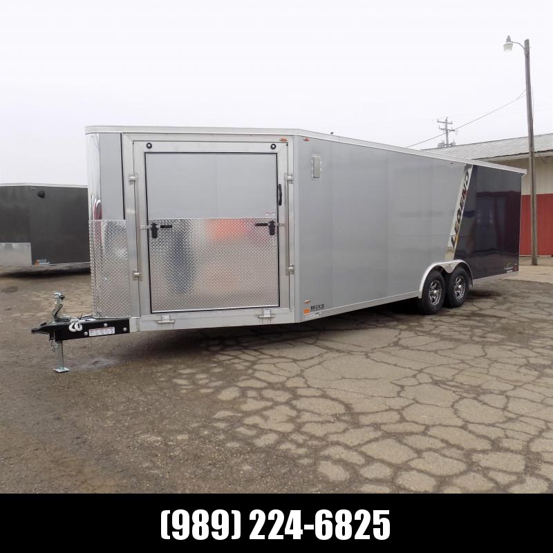

Trailer #3 Legend Trail master 8.5ft x 28ft (6ft V so 22ft box) (about $21K)
+ Perimeter frame built similar to the Intech (maybe slightly less stout, but still head and shoulders above the Triton, which wasn't flimsy)
+ All doors and framing were built by legend (the cargo doors were very nice and how the door fit in the jam was better than the other 2)
+ The 44in wide man door was awesome and would be nice to used suited up with even a backpack on without worry about bumping a side, "fat man" approved
+ The man door had a nice handle
+ Included a helmet cabinet
+ Similar LED interior lighting setup as the InTech
+ Salem and Roof Vents
+ Lifetime structural warranty, 25 years for wood floor and roof
-- Cam bar cargo door closure (least "slick" operating, yes they are all new and the cam bars will always just work and the mechanism isnt internal to the door or door frame)
-- Fully Welded but the stripped trailer frame sample in the showroom had every cross member welded on 3 sides, not completely around
+ 5yr warranty
All three of the above would still need added shelving, cabinets, coat hooks, and caliber / superglides added. It would be nice to also have heat, even if in an un-insulated trailer, just to melt off the snowmobiles. Neither dealer would do any of the mentioned install for me before delivery so that would all involve me purchasing and installing on my own.
