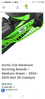

I have the ones for the ZR 858, part number 8639-374. They blend into the rear bumper like they are suppose to that i believe wouldn't happen if they were for M sleds.

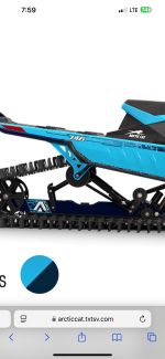

I’m pretty sure they are different looking at the rear lower support where it bolts to the axle. The m looks longer and more down and the zr looks shorter and back. Hard are some pictures first the riot in orange and then the blue m.
