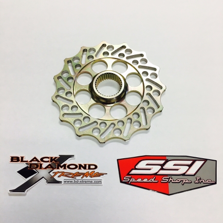

In '18 I thought cat lightened their brake disc for the mountain cat even more than the 17? watching a BDX vid a while back, the brake disc is solid on the Mountain Max. what were the alphas coming with? how about the catalyst?

The solid disks that started coming on the Ascenders are quite a bit thinner than the old proclimb "snopro" rotors with holes. If you look at the one on the blast he showed you can see it's thicker and the superlight rotor on that one is the old design that's also thicker. The superlight rotor in his hand is a completely different design to replace the thin mountain rotors.

not sure id want to have it milled even thinner. I like the BDX on mine but I did spend a little time de-burring the holes. The blast sure could have been a lot lighter from the factory, what a shame
