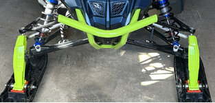

I have a bmfab front and a backwoods bmp rear in my garage right now both are built very nicely. As far a Polaris neon goes the backwoods powder coat is a perfect match and the bmfab is a bit lighter shade. Will be fine for the front but if someones trying to color match the factory tunnel paint backwoods bmp has it nailed perfect

Post a pic of the hue

It’s hard to pick up in the shop light pics but noticeable in person
BMP is identical
BMFab is a little different, lighter in the sun
The build quality on both are excellent
…from a BMFab repeat customer so no bias, observation only
Added different pics

The spindles are factory. The bumper is close but a little off. No biggie but noticeable. Will look better after some tree bashing scuffs😂
