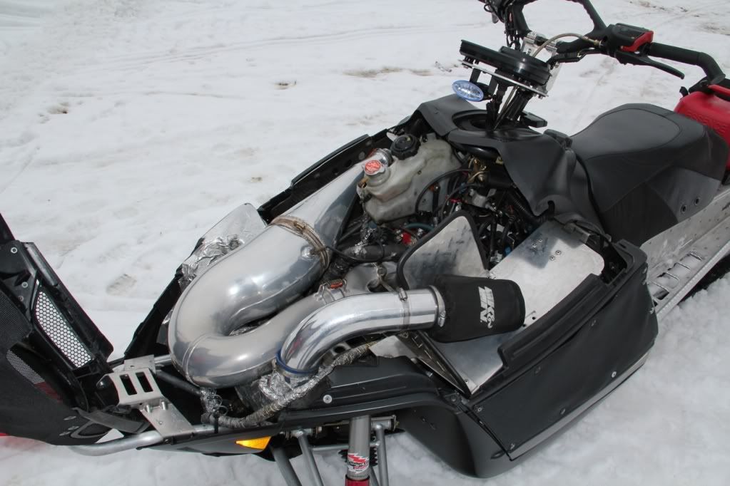

With the F and I kit does it open the side up to allow for better cooling instead of the big stock one that covers the clutches like a blanket and keeps them from cooling down? Any pics that anyone could post would be appreciated! Thanks guys!!!!
http://www.firenice.us/store/fresh-air-intakes/2005-2006-polaris-700-900-airbox-kit.html
This intake will also allow you to install a Skinz front bumper which is substantially stronger than the stock plastic garbage and much lighter too.
I have a fire n Ice on one and a slp on another. I like the F&I for all the reasons mentioned. The one caution is that it may sit right next to/on the exhaust at the front end. Use plenty of heat tape. The first time I did not and after the first ride had slight melting of the box. Put about four layers of heat tape and no issues since.
