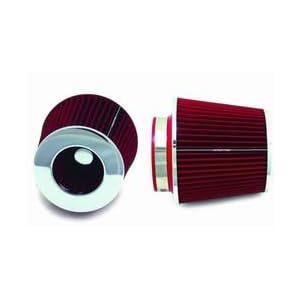

don't have time this morning but i will take some better pics. it really is simple here are the basics.
1 buy a 4" mass air adapter i will have part number tomorrow
mass air adapter
2 buy a 4" flex air intake tube
4 inch flex hose
3 buy a 4" air cleaner
4" cone air filter
i will have part numbers tomorrow of the stuff i used i had about 85 bucks in my but my shop payed for it so i had 0 out of pocket ;)
cut 1 inch off of the hight of the adapter then place the adapter over the stock boost box opening and center it the best you can then drill some holes in the aluminum not th air box so the will line up with the lip on the boost box.
then i used some small screws to hold it in place. after i liked its position i removed the boost box, removed the screws applied a bead of silicone on the lip and installed screws again. then i used silicone to fill the gaps.
i will take some pics and post them up. it is really really close to my pipe, almost touching so i put 3 layers of the reflective tape on it after i installed it.
mass air adapter
4 inch flex hose
4" cone air filter
