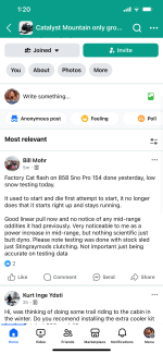

This reflash is cleaning up the fueling at mid range is what I am told. Supposed to make them run better! All of our sleds that we got need the reflash done, calling customers tomorrow. I am sorry some of your dealers are 3 hours away. If your coming through northern Utah I would be happy to meet you somewhere and do the reflash! Sometimes saving $200.00 has its drawbacks!! Imagine if you owned a Polaris, you would be upside down with all the fuel cost, just to get it to the dealer for recal
I might take you up on that offer , are you open the 20th?
First review on the reflash I’ve seen. Some of the wild mid range increase claims might have to be revised. Time for an updated podcast Snowest? 😜
Had mine done today, rode it when I got home in my yard. Hard to really say based on sample size, but I'd say better snap in the mid. Mine never had an issue starting up but I agree with the rest of his post. Still loves 8300rpm lol.
