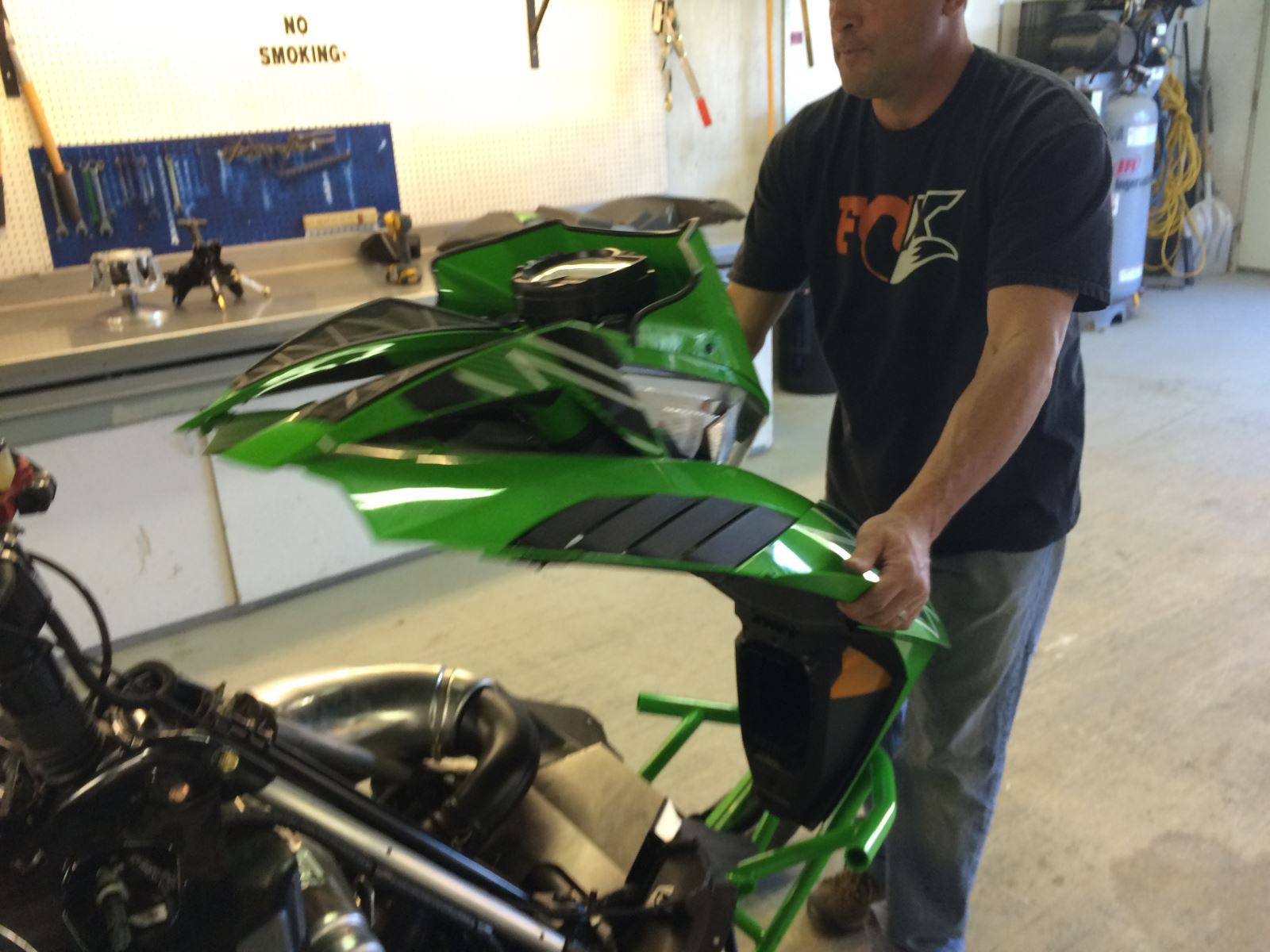

1) Remove the hood. (This is the hardest part of the process.) Even though just removing the right side panel exposes the can, for best access to the springs that need to be pulled, you need to be able to come from the top. There are six screws that attac

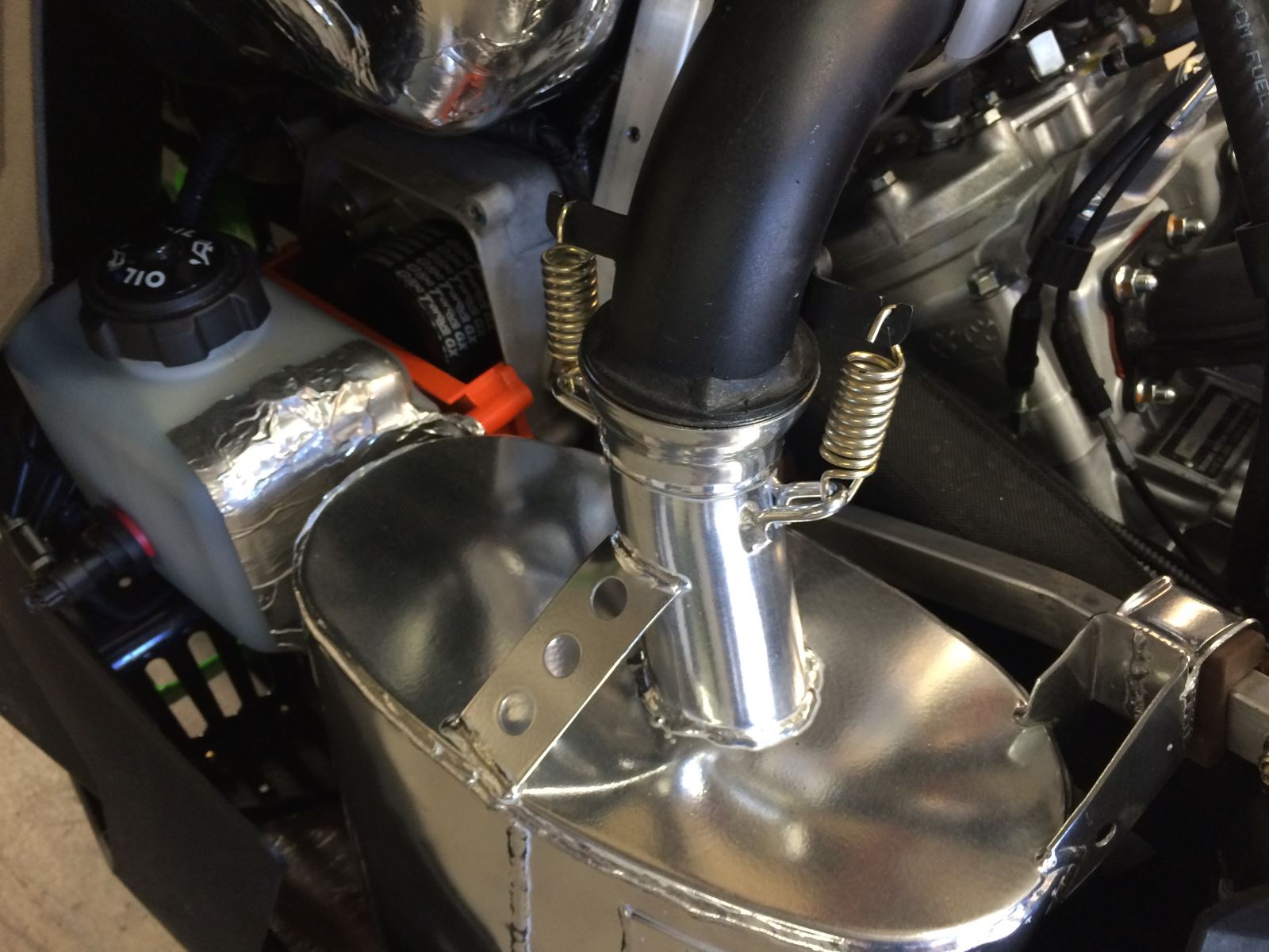

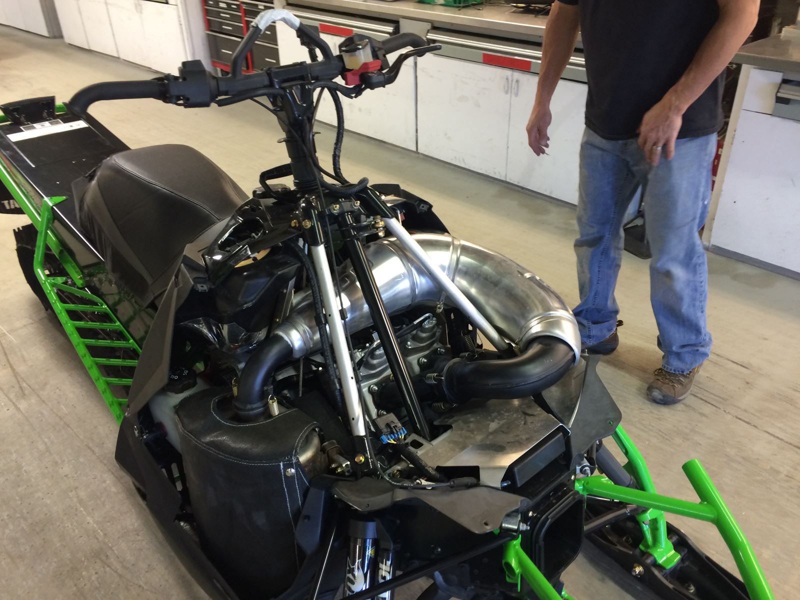

2) Remove the muffler. You’re dealing with about four springs—two that attaches the pipe to the muffler on the top and then a couple on the sides that hold the muffler in place.

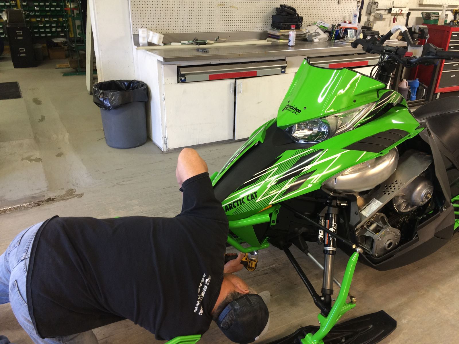

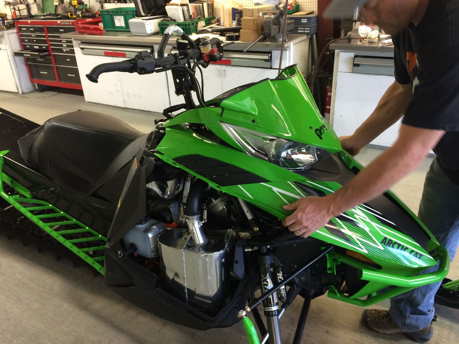

1) Attach the muffler to the sled and pipes by re-attaching the springs.
