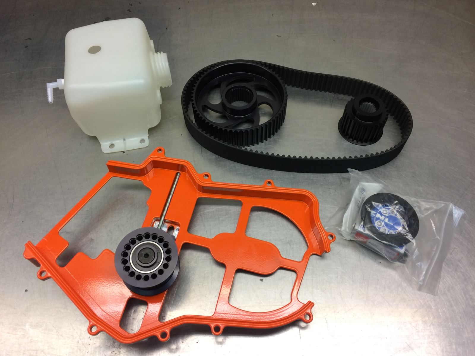

In this story, we’re looking at a cool install of a belt drive system—something a little different from your standard Arctic Cat accessory parts—that we’re adding to our 2015 Arctic Cat M 8000 SnoPro.
This belt system, manufactured by Mountain Valley Machine
(http://mountainvalleymachine.com), is a lightweight performance enhancement drive system that not only eliminates about 3 lbs. of rotating mass, but also sheds another 11 lbs. because we were able to remove the chaincase, chain and gears.
This is a slick install kit that is clean and simple. It’s also a system we can’t wait to test out on the snow.

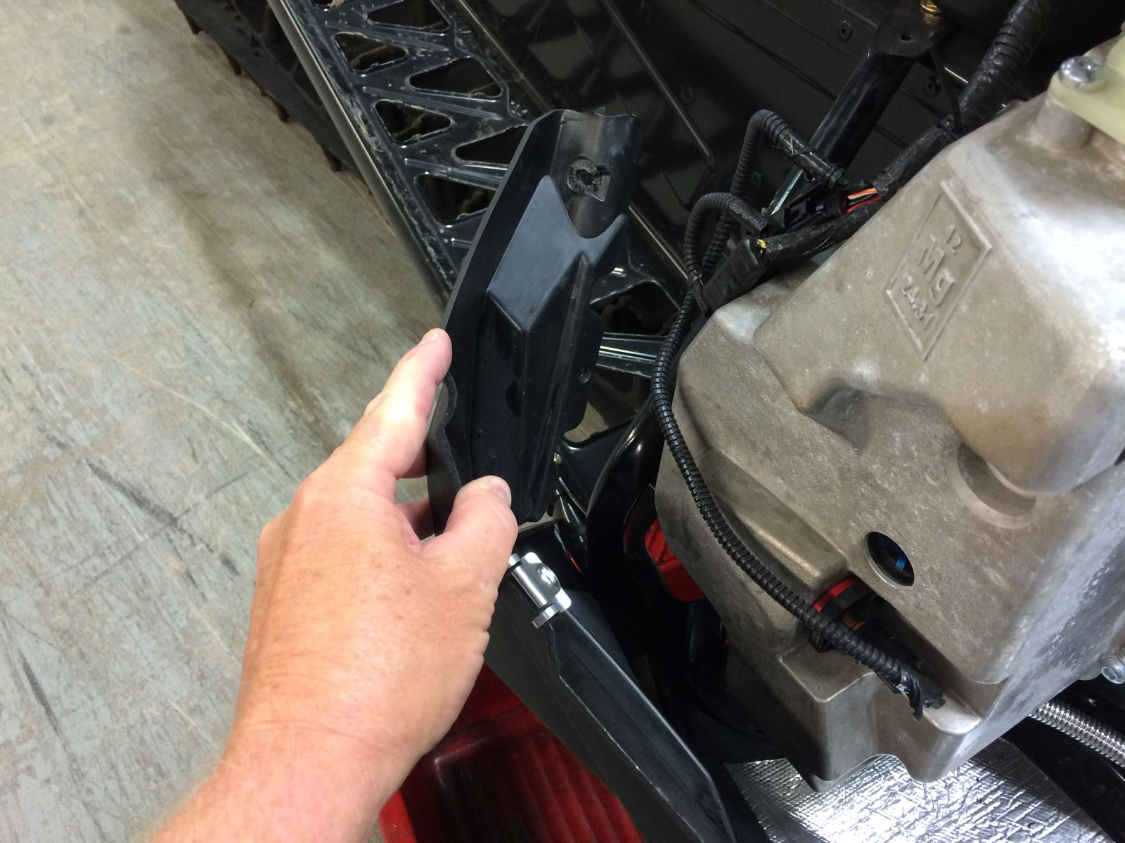

1) Remove hood. This will allow access to the chaincase.
2) Remove screw that holds belly pan to the foot rest. 3) Remove pipes. Again, for access.

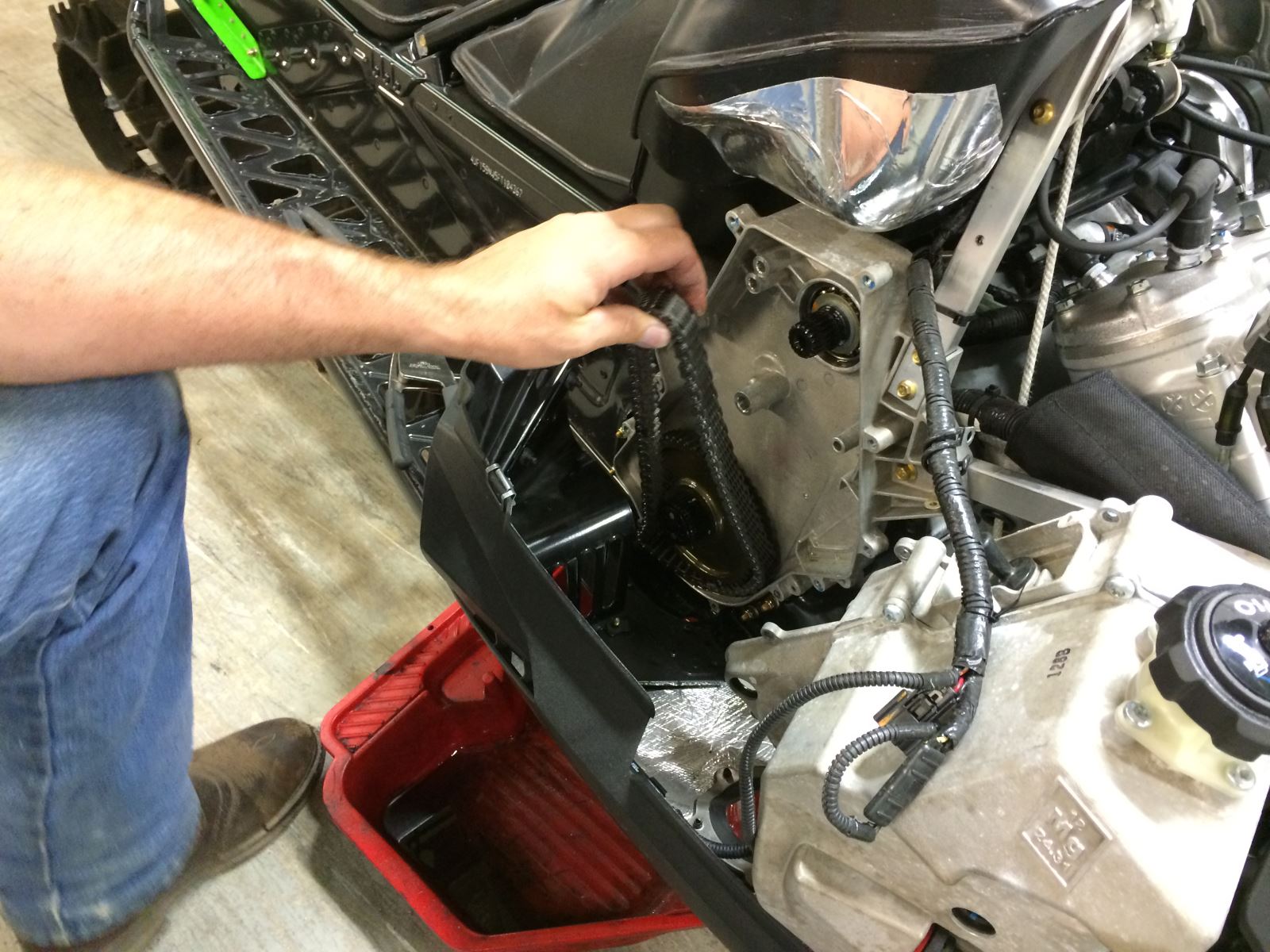

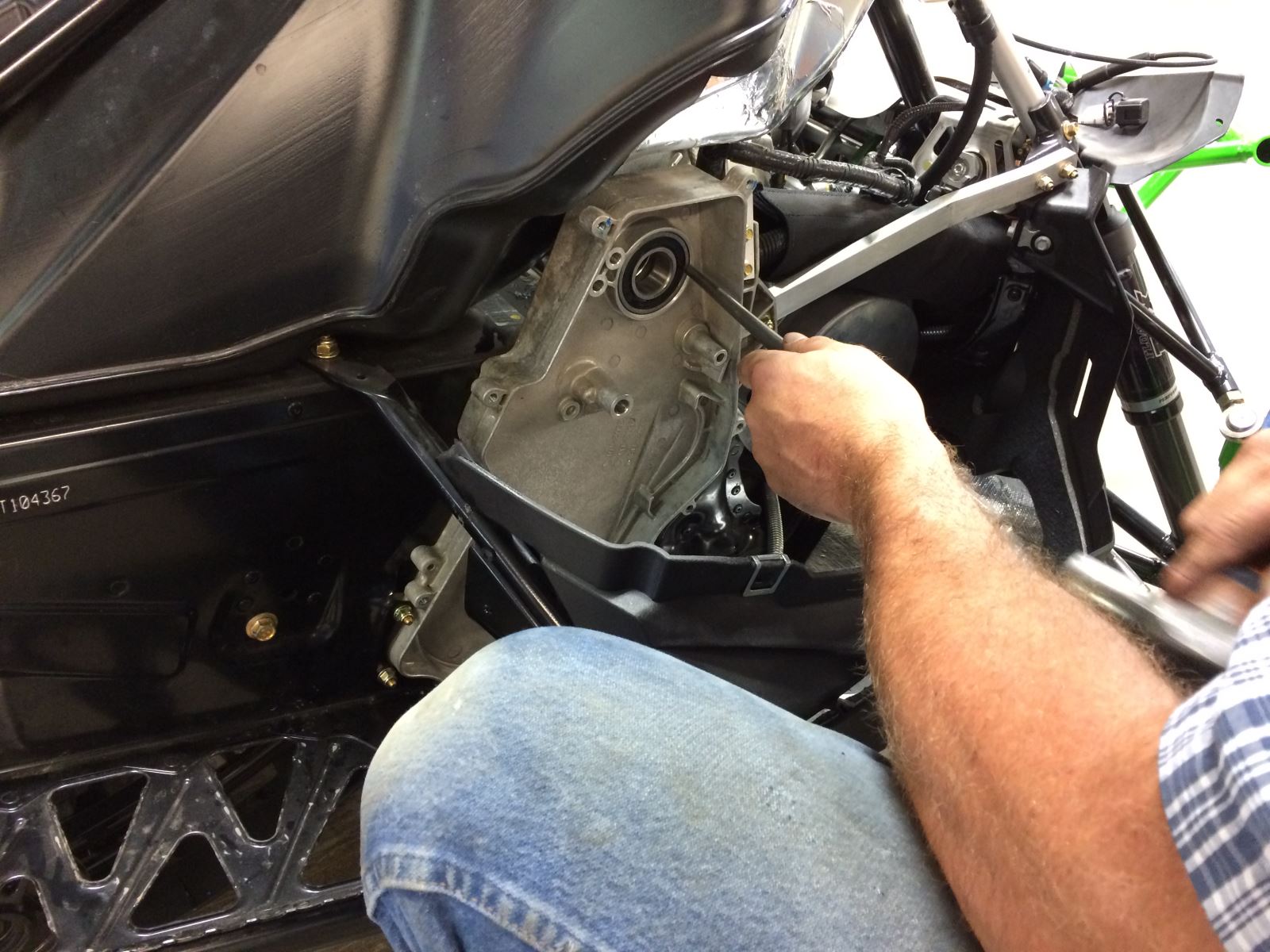

4) Pull chaincase cover (11 screws). Make sure to place a catch pan under the chaincase to catch the chaincase oil.
5) Remove c-clips that hold the gears. Remove the top gear and chain and then the bottom gear.

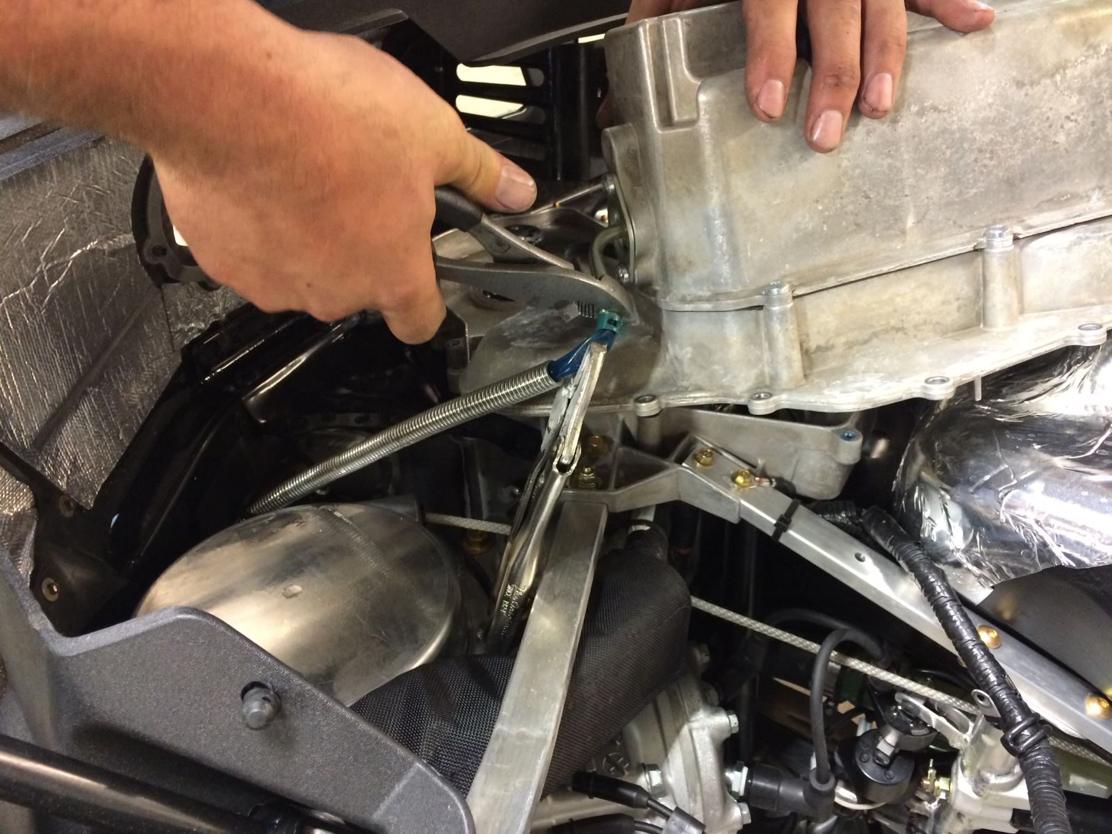

8) Kink oil line (since Cat incorporates the oil reservoir with the chaincase cover) and remove it from the chaincase. (Be ready to catch any spilled oil that may come from both line or chaincase.)

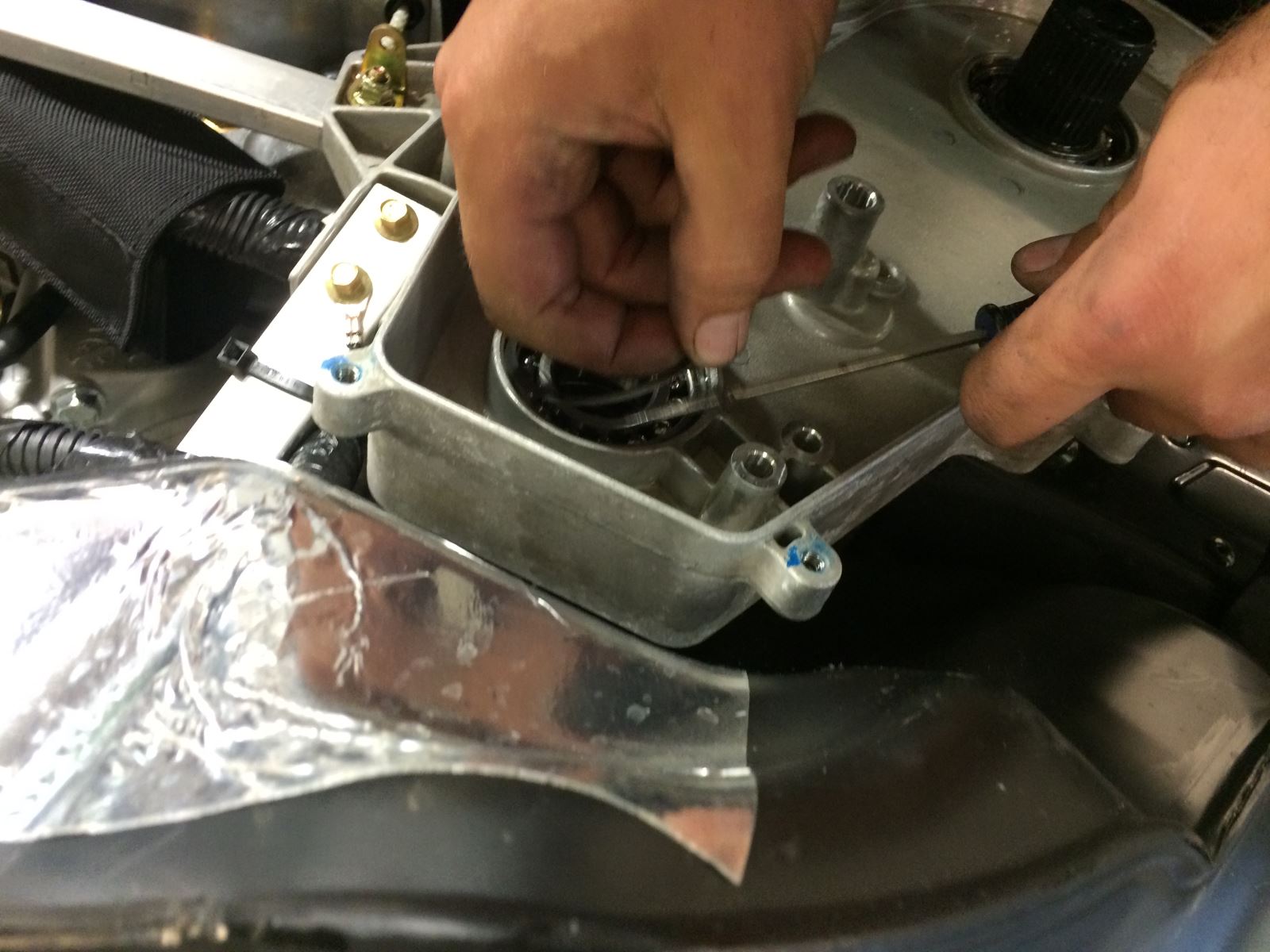

10) Remove the c-clip that holds the jackshaft to the bearings.
11) Remove the jackshaft by pulling it through the clutch side of the snowmobile.

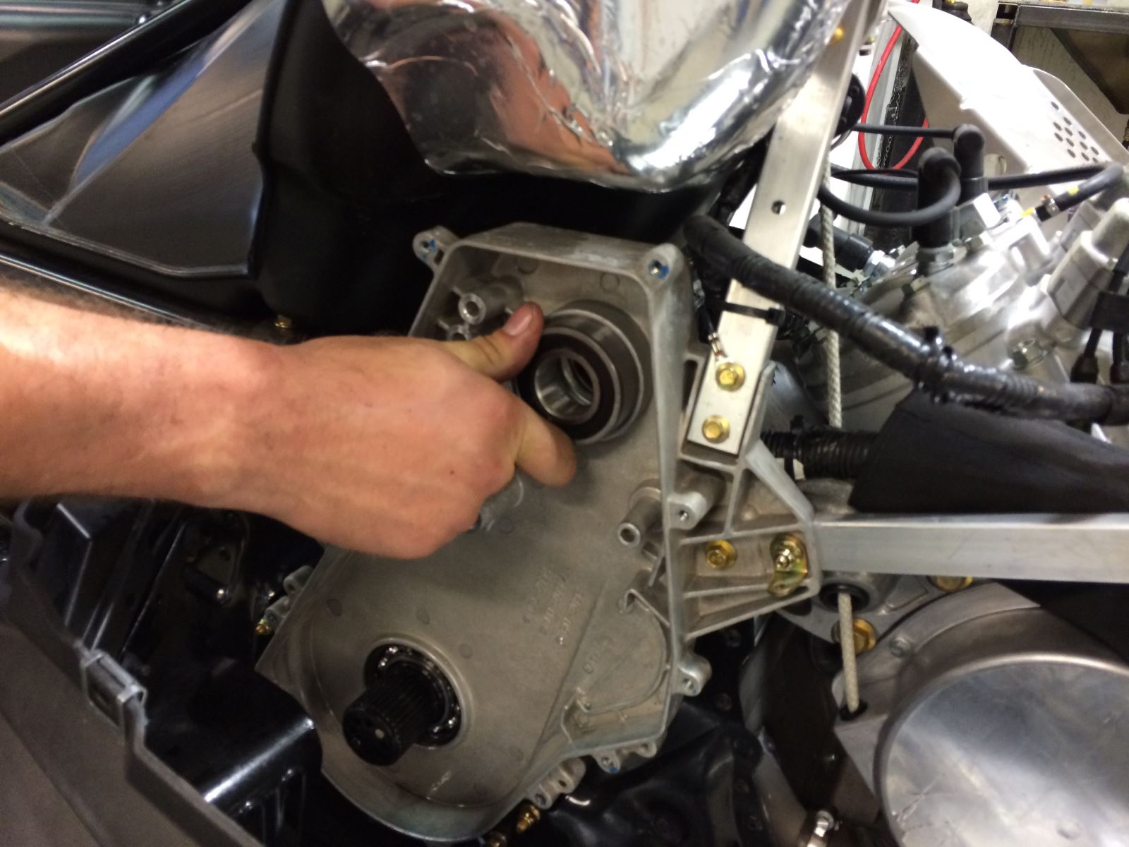

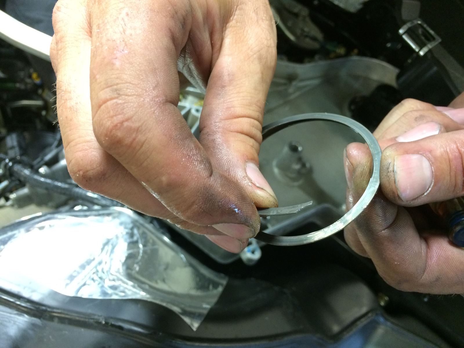

12) Remove a split shim that holds the bearings on chaincase side of the sled.

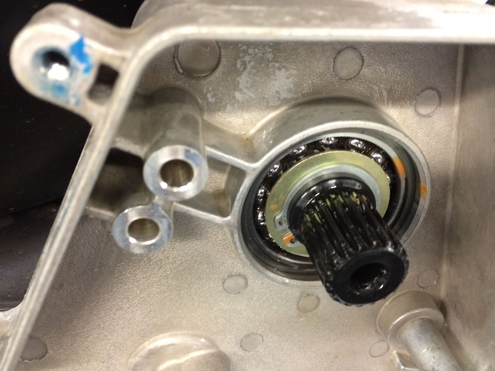

13) Remove the bearings (this may take a little bit of nudging since it’s a tight fit).

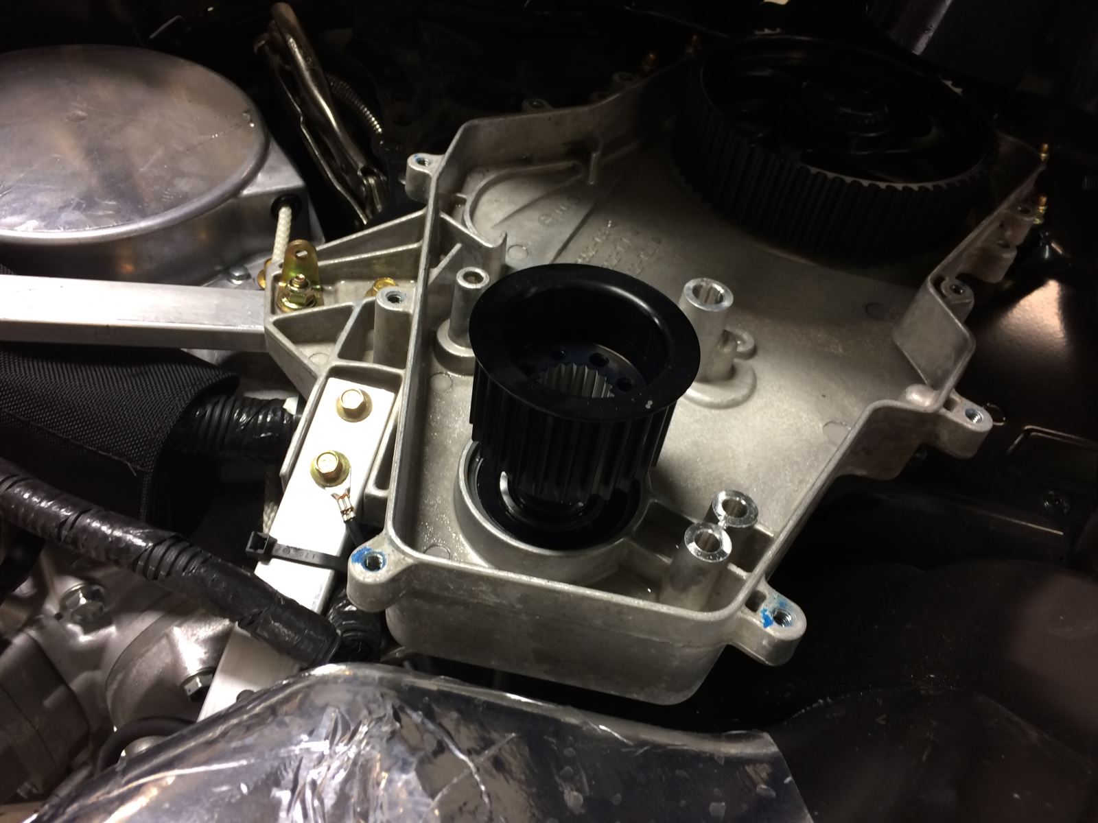

1) Replace top bearings with bearing supplied in Mountain Valley Machine belt drive kit. You will want to softly tap around the bearing to seat it into position … but don’t ding up the seal. 2) Re-install split shim. 3) Re-install jackshaft.

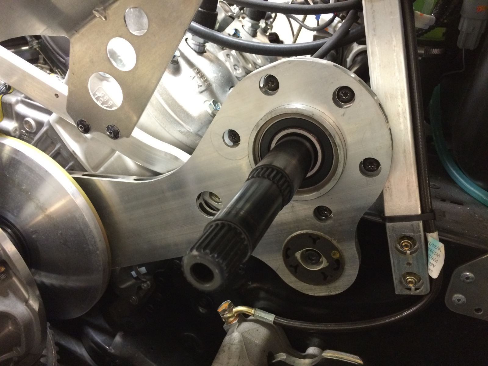

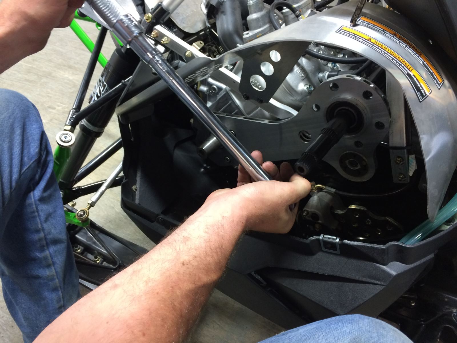

4) Re-install torque plate. (First put all 10 bolts in position and start snugging them up to make sure it fits without any binds. Then torque the four bolts near the drive clutch to 25 pounds and the six bolts near the driven clutch to 14 pounds.)
5) Re-

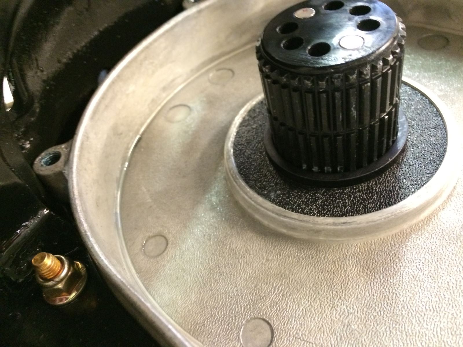

6) Install plastic collar over the drive shaft bearings, then the plastic seal.

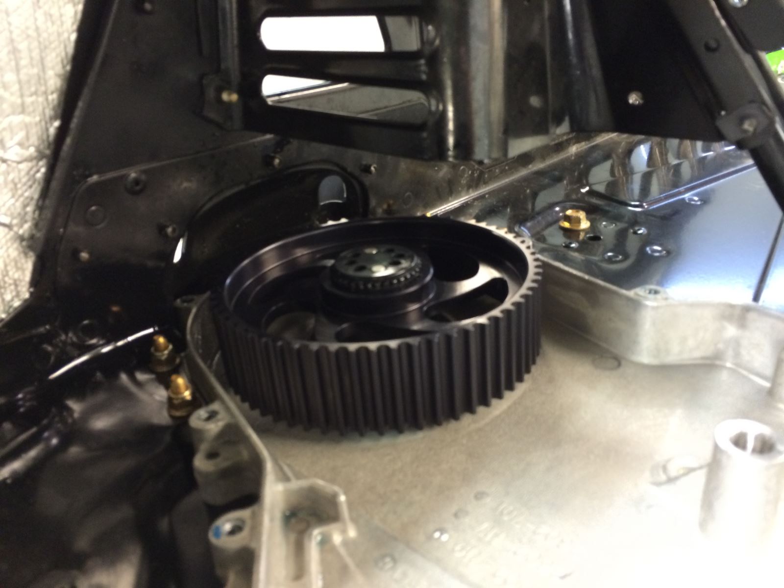

7) Install bottom belt drive gear.

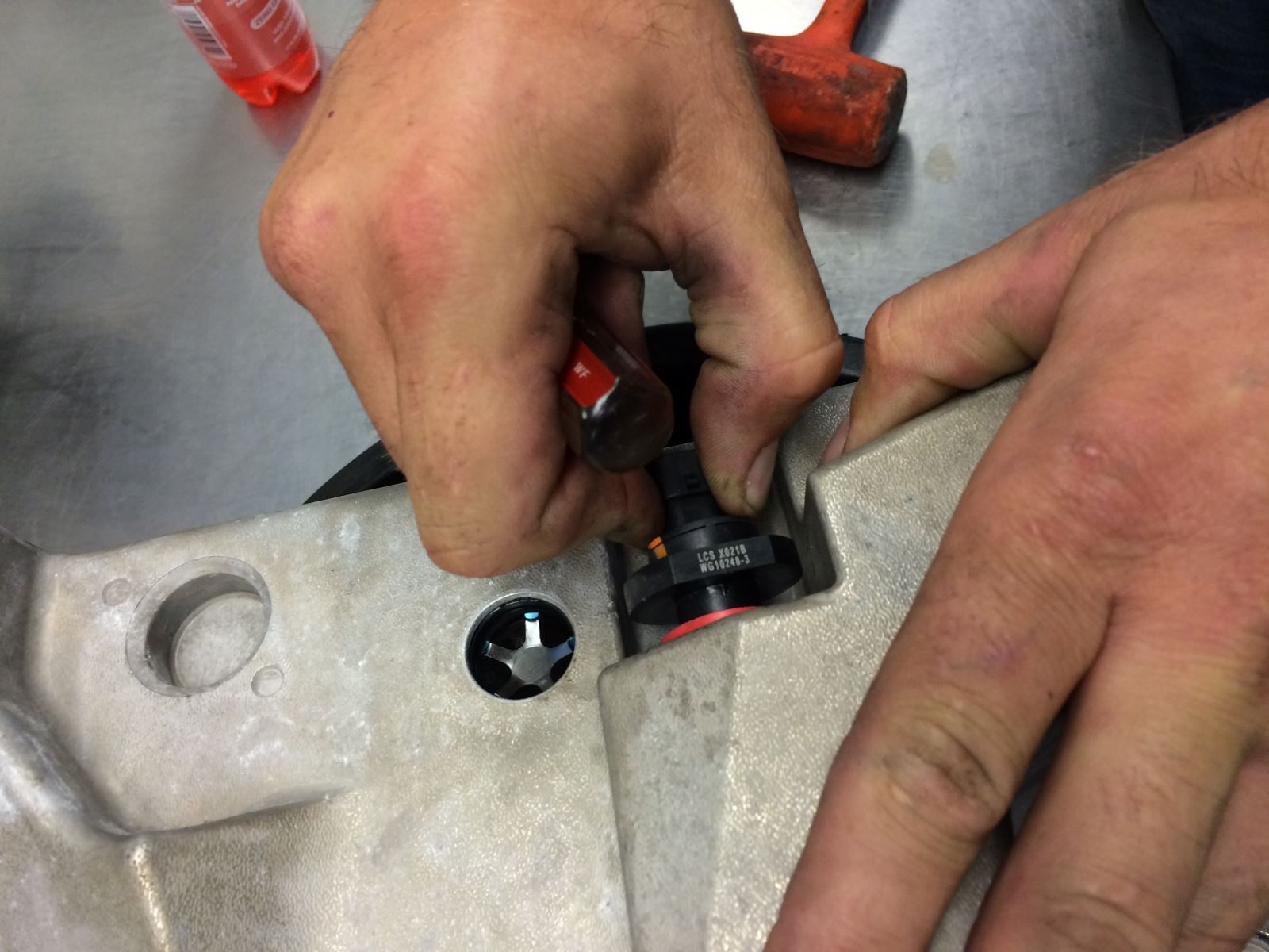

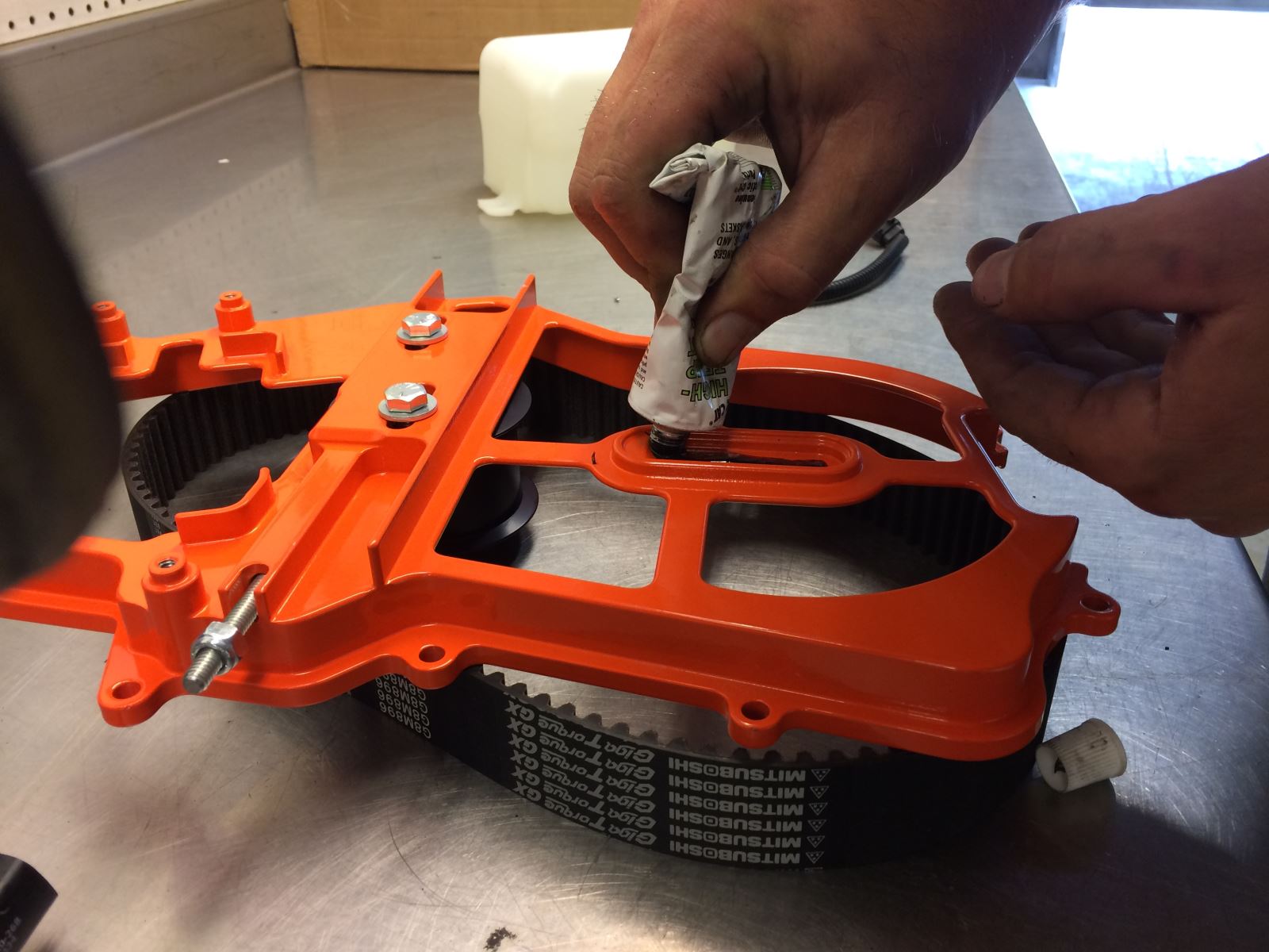

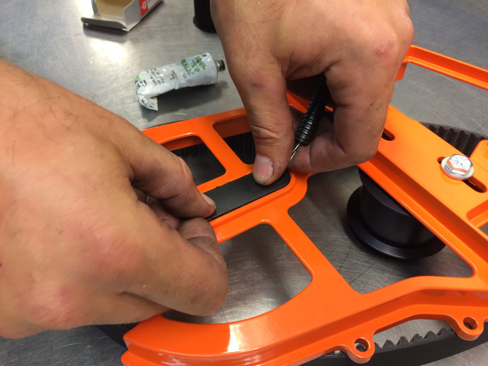

8) Remove odometer sensor from the chaincase. This is siliconed in position so you will need to scrape around the edges and then gently pry it out of the chaincase. Once it is out, clean off any excess silicone before siliconing it into the Mountain Valle

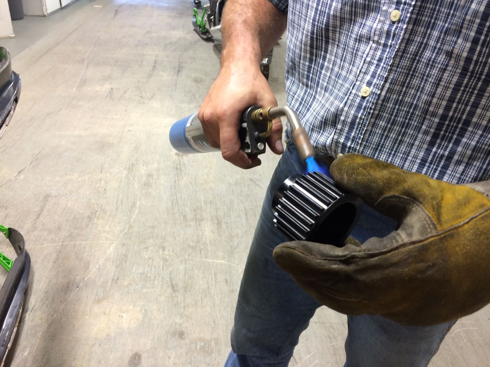

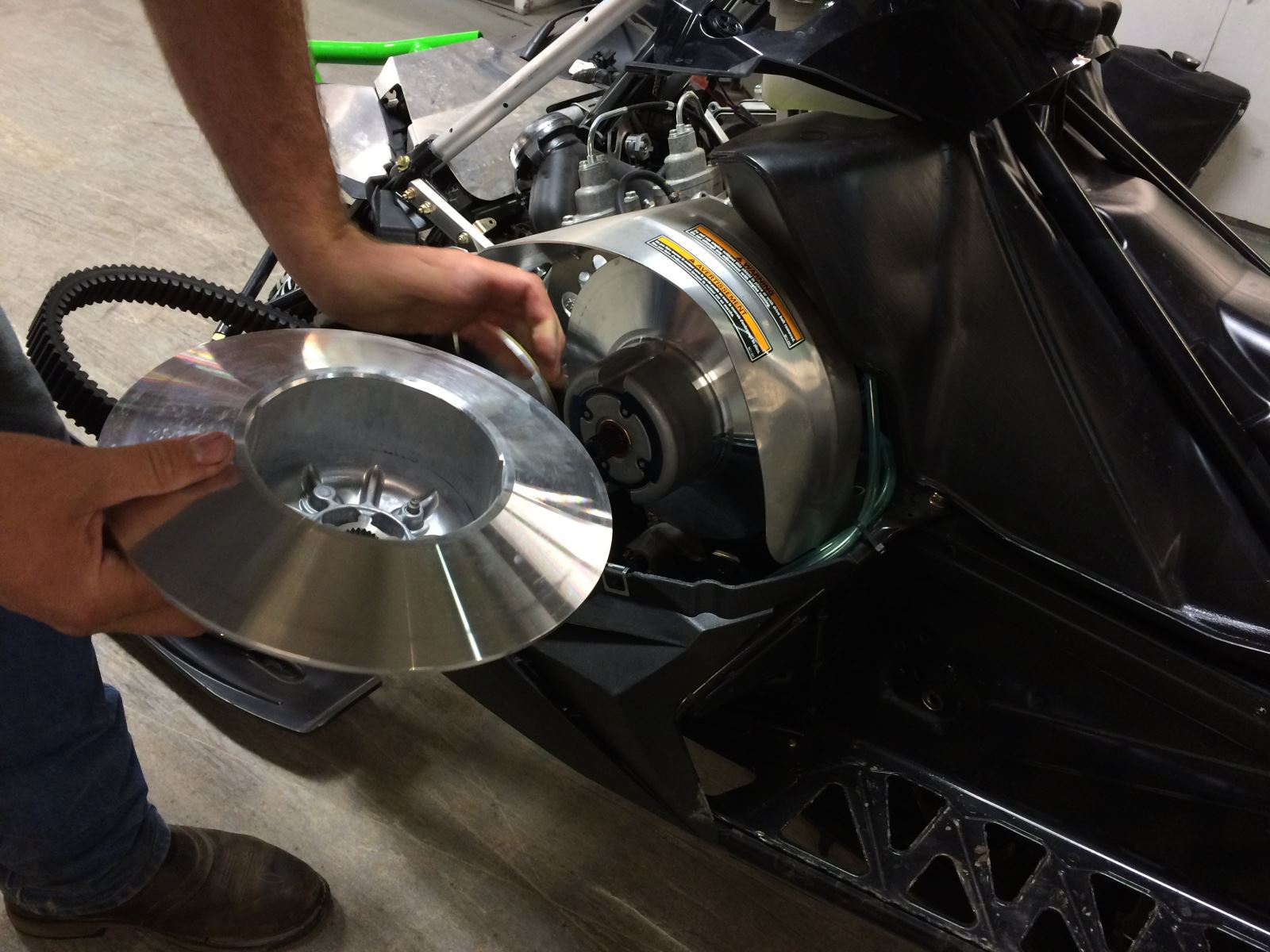

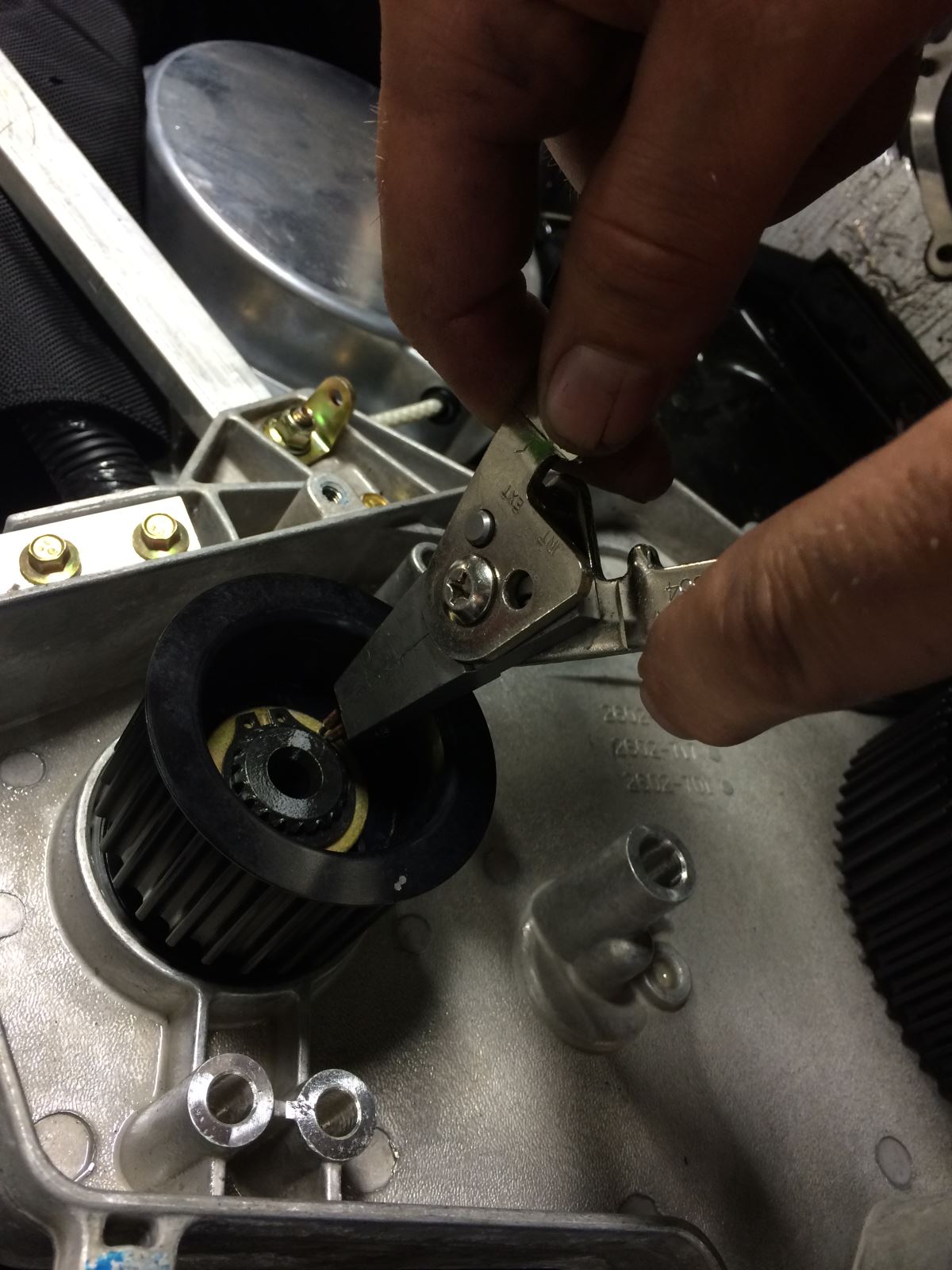

9) Install top belt drive gear. You may need to heat it up a bit because it is a tight fit. It needs to go on far enough to add the shim and then secure it in place with the c-clip. Once installed, it will snug up tight to the jackshaft. 10) Install belt

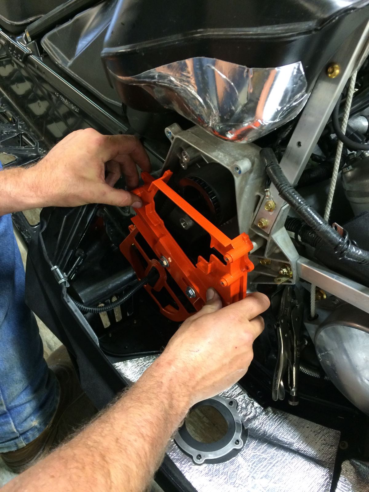

11) Install belt drive cover, making sure the tensioner is located outside of the belt. Tighten the belt to where you can only get about one-quarter inch movement one way with your pointer finger and thumb.

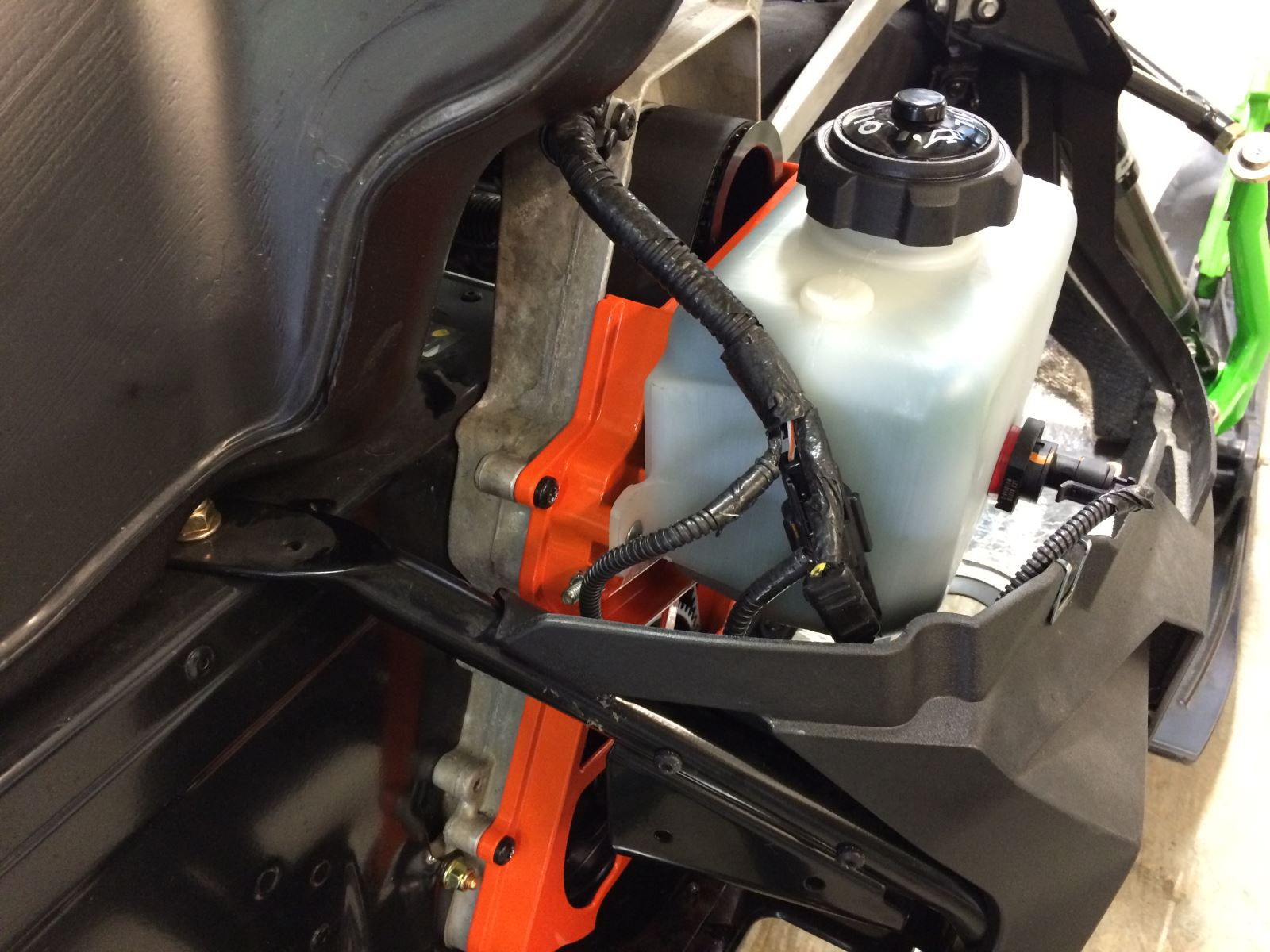

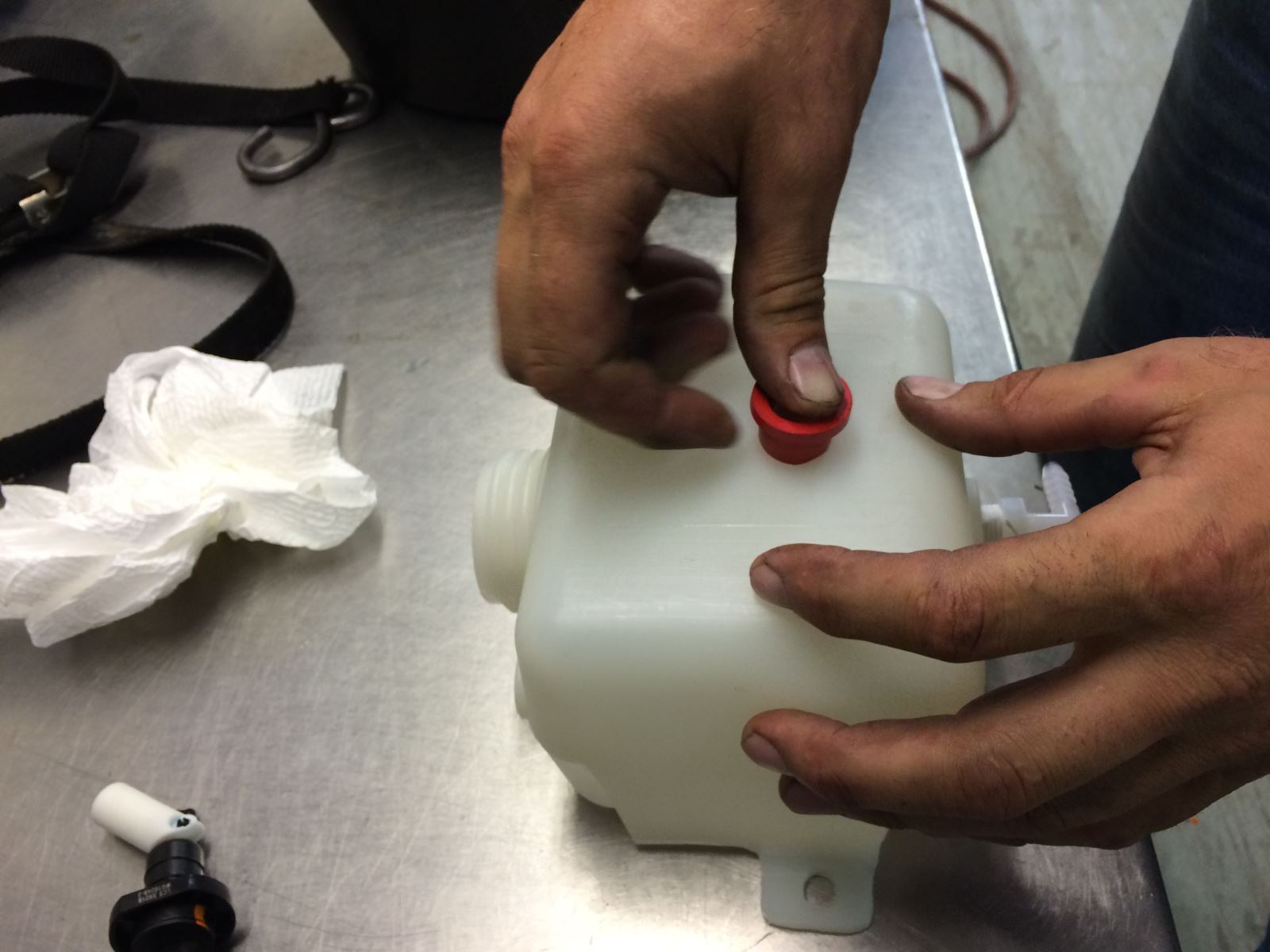

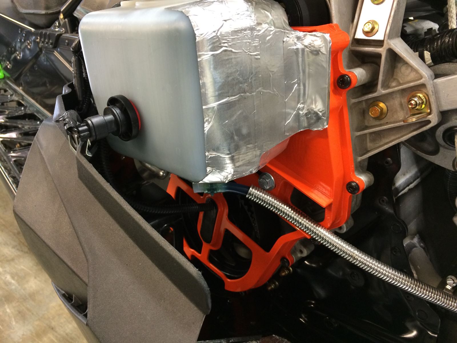

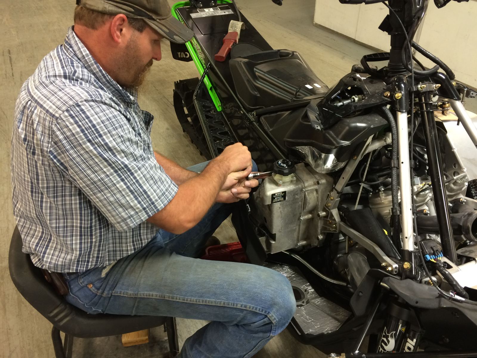

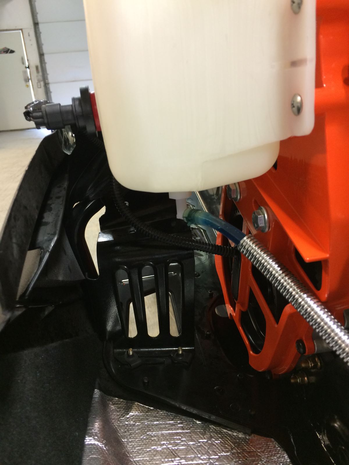

12) Remove oil sensor from stock oil reservoir and install it in replacement oil reservoir. Make certain the float tilts to the bottom.

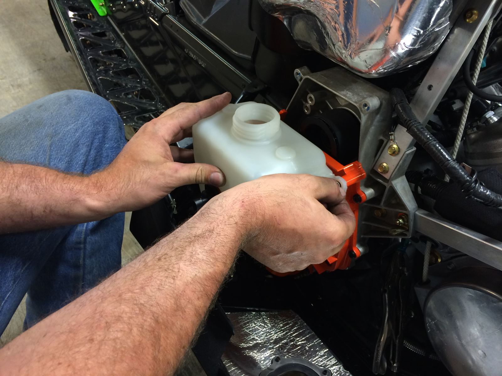

13) Attach the replacement oil reservoir to the belt drive cover. There will be three screws and the reservoir will only fit one way.

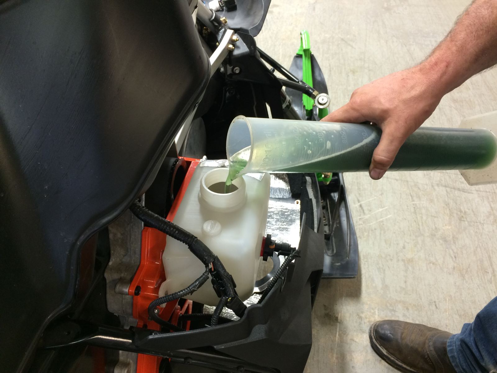

14) Re-attach odometer and oil sensor wires, as well as the oil line to the replacement oil reservoir. Fill oil reservoir and make certain all the air bubbles are out of the line. New reservoir holds 1,800 milliliters of oil (700 milliliters left when low

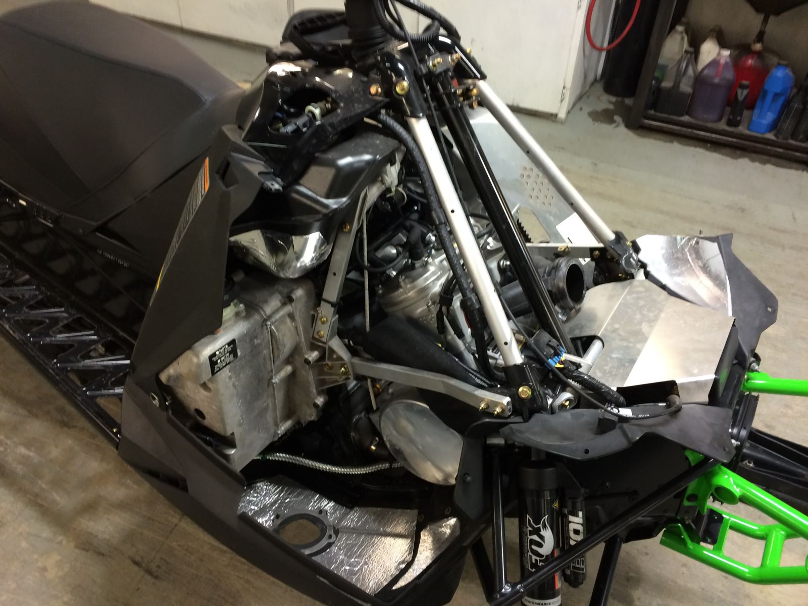

15) Re-attach belly pan to foot rest with screw.

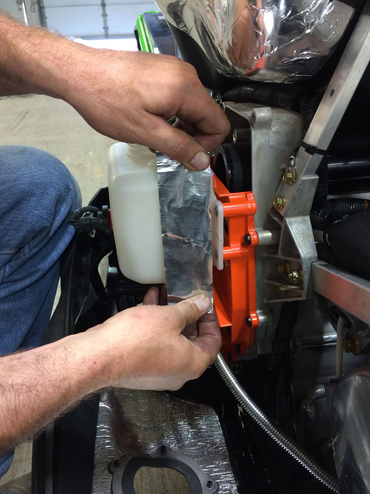

16) Re-install pipes. (We put some heat tape on oil reservoir where it gets close to the pipe … although the Cat pipe has sufficient heat insulation.)
17) Re-install hood. You’re ready to ride.

love the look of the belt drive, nice mod. Does the oil system need to be purged after changing the oil resevoir to ensure the engine doesn't run without oil the first time it is started?
If you keep the oil line up high and make sure not to get an air bubble in the line you will not need to bleed it.
