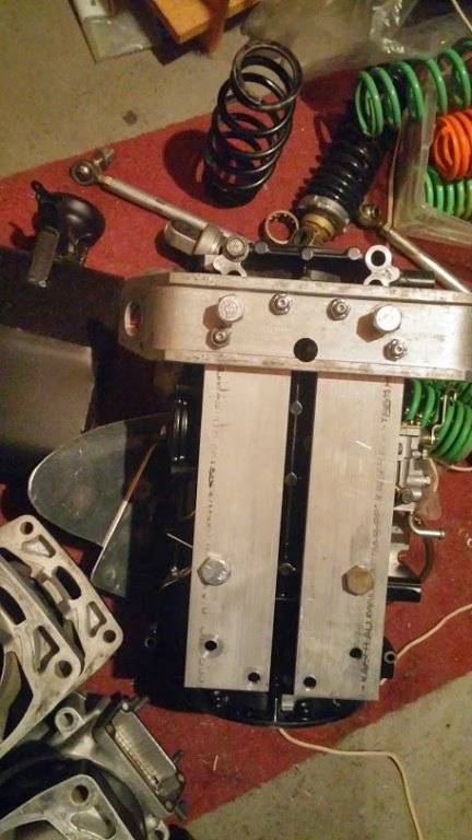

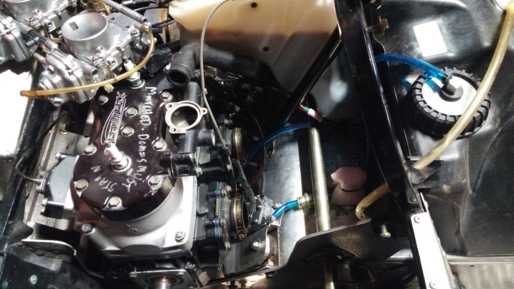

Started initial fitting of the motor:
Looks pretty good, think this will fit without a ton of mods necessary.

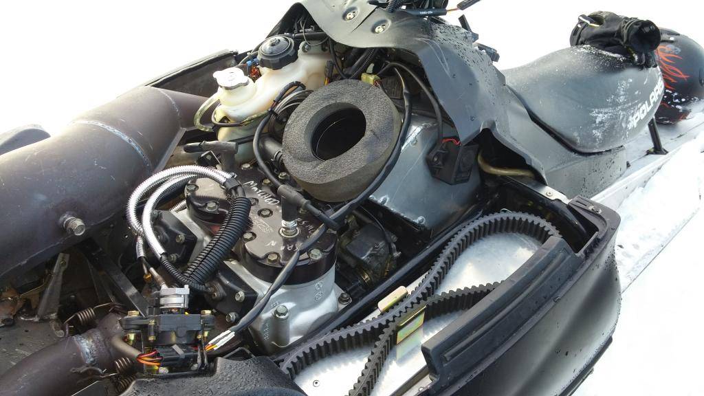

We tried to set up to run the same belt our King Cats do, but the C-C is too long. So we're running M8 belts. 0627-046

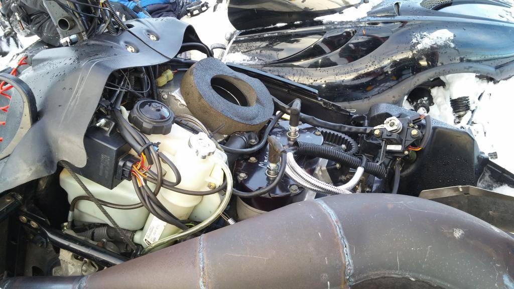

To mount the motor, we used two stock RMK PTO side motor straps. Replaced the stock mag strap with one of the stock PTO side straps. This gave a level surface. We bolted two additional straps between the stock mounts, and bolted to the bosses on the Cat crankcase. PTO side could almost work with the stock location. You could get the motor slightly lower using a plate, but we ran into issues as is with carb clearance, and with the crankcase hitting the bulkhead on the PTO side.
Mounted the fuel pump to an aluminum scrap bolted to the motor strap. Fuel line is just plumbed to a plate blocking off the hole for the EFI fuel pump.
Stock RMK oil tank and coolant bottle were used. This sled had the heat exchanger in the front of the tunnel, and it is plumbed to a secondary loop that bypasses the thermostat.
Not pictured, but we used the stock RMK torque stop, just cut and re-welded it to fit the larger motor.

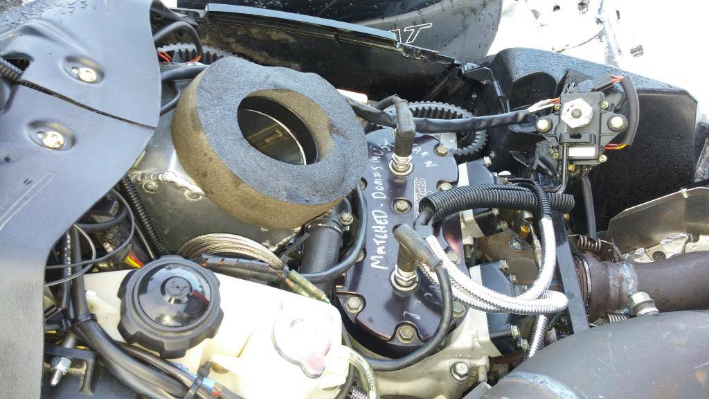

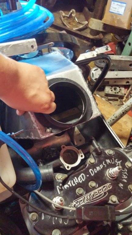

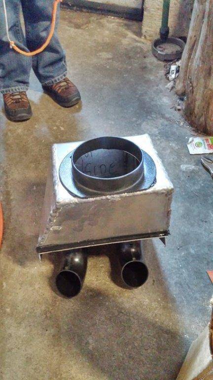

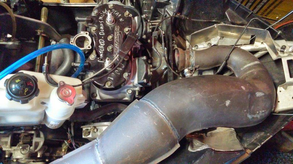

Cut the bottom off a stock King Cat airbox, to fit the carb boots. Had to modify it to fit around the jackshaft. Built an aluminum top, that holds the stock Cat baffle plate, and matches up to the stock RMK intake from the hood. Nearly hits the thermostat, but clears.

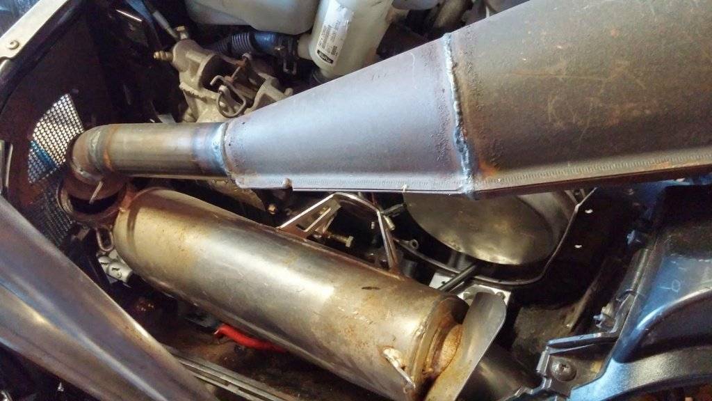

We measured the stock Cat 900 pipe, and our Black Magic singles that we run. Turns out the stock Cat 900 pipe is almost exactly the same dimensions as the stock Polaris 800 pipe. Cat pipe is ~2" longer. The Black Magic pipe was a larger diameter, but slightly shorter than the Cat pipe.
We cut the tail and head pipe off a stock Cat pipe, and likewise the stock RMK pipe. Welded the Cat pieces on the Polaris, matched it to the can we are using (SLP M1000 can), and called it a day.
We did have to cut the top spring mount off the y-pipe, as it didn't clear the strut brace. Mounted one on either side to compensate.
The can is mounted to the frame rail on the PTO side, and a brace underneath. No can modifications necessary, so should be able to use any M1000 can. We did have to put a rubber bumper on one of the chaincase mounting bolts, to keep it stable.

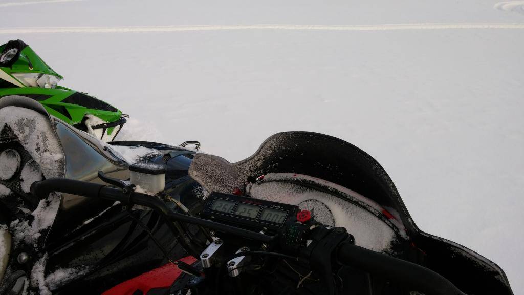

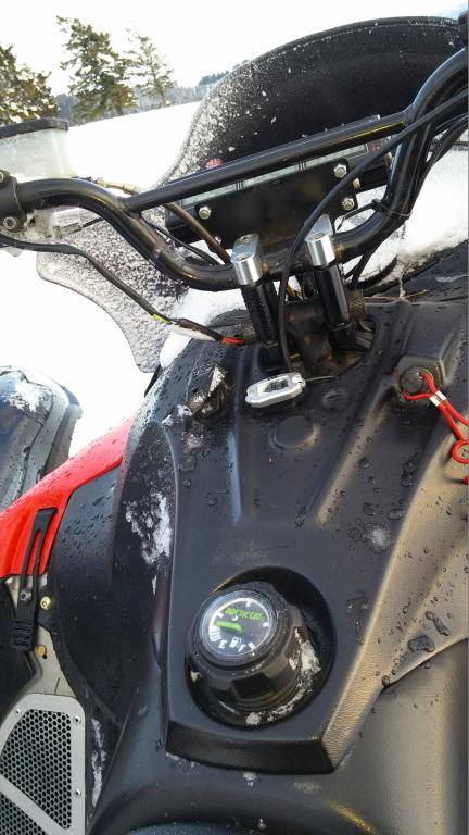

We didn't try to hook up any of the stock electronics, so the only gauge is the Avenger III. EGTs and Tach.
Used handlebars from a Cat Sabercat, because we like the bend to them. The chassis came with a broken gas cap, but luckily older Cat ones fit just fine. Not accurate, but it plugs the hole.

Looks like you bagged the pipe insulation shield eh? I still dont think it is as nessesary on a carb engine. Mine seems to have some fueling quirks that i need to figure out, gotta get some egt probes in there and see which way its going, but otherwise i had similer results, seemed to run at least as well as a '14 pro 800, when it was fueling right. Next step: pro chassis. :face-icon-small-coo

We are still planning to put the heat shield back on, to protect the wiring harness, it just didn't get finished yet.
