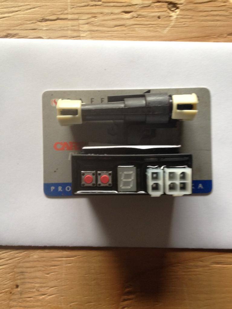

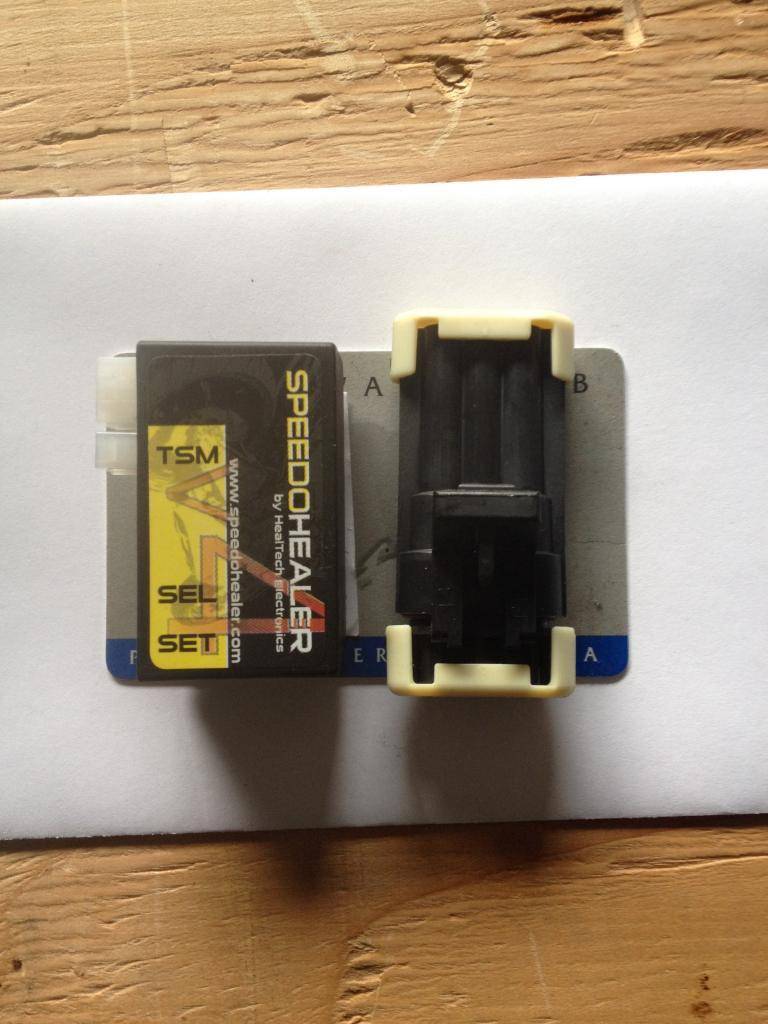

Pictures can be so deceiving, This unit is about the size and weight of your key fob. It is literally the same size as the Stock Delhi speed sensor connector pair. With the optionally installed top speed recall remote wiring and the plug and play connectors it weighs in at 145 Grams (Same weight as my Iphone 4S). The wiring weighs more than twice what the unit does. This cute little unit will fit anywhere, The remote top speed recall switch wire is just over 6 1/2 feet long, and the plug and play harness will be a little over 3'. This would allow placement anywhere under the hood. There are a few switches on the unit as well as a 1 digit display, that for calibrating the unit should be accessible / visible. The adjustment range is incredible (-99.9% to +9999.9% in steps of 0.1%) essentially unlimited, especially for sled use. It opens the possibility of using the stock speed sensor and feeding the correct signal to Yammi or Cat instrument cluster for those that are building ProPex's and NyPRO's and possibly a VIPRO or something (note the instrumentation input would need to be verified but HealTech has been very helpful thus far and he designed it to allow for these sort of creations when he engineered it.
If you do not see a need for the top speed recall feature the weight goes down to 92 Grams.
These pics are both the Delphi connector and the actual Speedo Healer unit on a normal credit card, a top view and a side view.
Hope this helps, for those that are on the fence about it.
