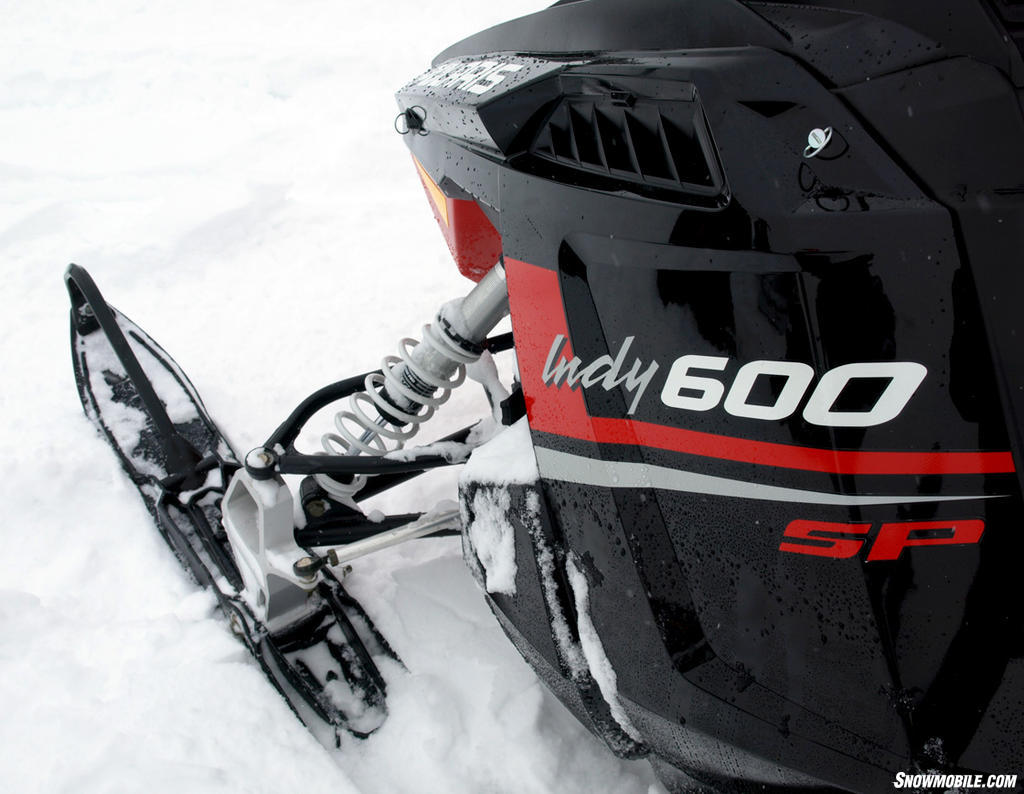

This is the same plastic that he IQ chassis side panels are made from and many others... all of the major wrap companies products have stuck very well to this plastic... as you can see by the factory graphics that are applied in the photo above. (those can be difficult to remove at times)

NOPE... That pic you show is of an INDY "SP" model like AK Full Throttle said... that has painted glossy panels...

here is a pic of 2013 indy 600. is this the side panel you are talking about?
